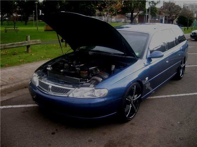

Model: 02 vx berlina series 2
Colour: delft blue
Bodykit:n/a

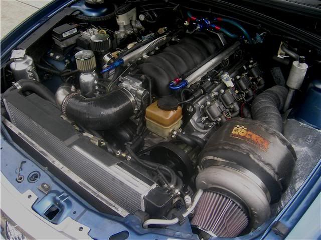

Engine Type: 6Litre iron truck block

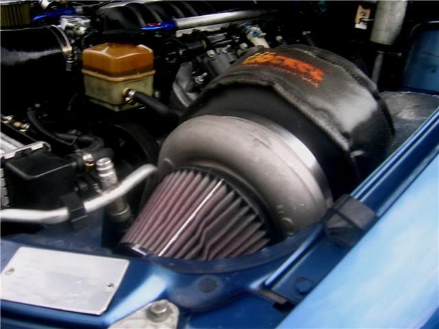

Engine Mods: iron block decked honed etc bored 30 thou, eagle 4340 forged crank 4inch stroke, scat forged h beam rods, arp cap screws, custom forged pistons 9.5 to 1 compression, total seal rings,clevite h series bearings,rollmaster double row timing chain, custom oil pump,25% powerbond underdriven pulley,stock cleanedup heads arp head bolts,cosmetic head gaskets,custom comp turbo cam,isky valve springs,ported throttle body =408 cubes borg warner S400w turbo 75mm compressor wheel 1.32AR exhaust external 50mm gate intercooler dual blow off valves
Power: 402rwkw@8psi, 420rwkw@9.5psi 10.96@127.4mph 455.8rwkw@11.5psi 10.86@130.96mph 472rwkw@12.5psi u98pump fuel yet to run have 16 to 20psi available if wanted?
Exhaust: russo custom single turbo kit 3.5 inch dump into custom dual 3inch dual high flow cats into dual 3inch xforce stainless system
Gearbox: 4l60e fully built best available by craigs automatics 3000 dominator stall transmission cooler transmax z oil
Diff: 3.73 gears truetrac lsd upgraded cv shafts

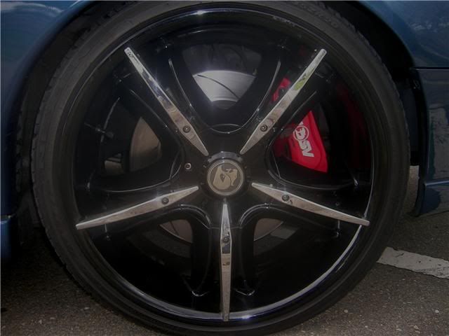

Brakes: hsv vz r8 350mm rotor 4 piston front 332 4 piston rear
Suspension: king springs koni adjustable shocks poly airbags in rear nolathane bushes throughout
Wheels/Tyres: 20x8.5 rpm black ravens hsv logos nexen 225/35/20s front nitto 555 extreme 245/35/20s rear 275/40/17 mt et streets on vy ss rims for strip
Interior: stock
Other Mods:walbro intank pump to custom dual internal pump surge tank dual 1/2 inch lines turbosmart 1200 fpr ase fuel rails 80pd z tronic injectors,engine oil cooler,powersteer cooler, turbosmart e boost2 controller,battery relocated to rear ,custom radiator overflow tank,fire extinguisher
Stereo: stock even blew up cd player with a cb radio a few years ago!
Build Period:ongoing for 6 years started with tune then went twin turbo now as is
Cost:plenty of overtime
Future Mods: up in the air if i want to keep racing roll cage harness turbo 400?? some nicer seats any ideas?currently daily driving 60kays a day over $120 a week in fuel!ouch !! love it anyway!!will try and post pics but if i can email someone to post for me would be easier pm your email cheers martin

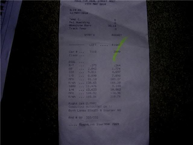

hi,mate only raced once for these 1/4 times at 11psi bounced off limiter a few times before hitting second gear only problem ever on the street daily 8psi runs perfect!!!

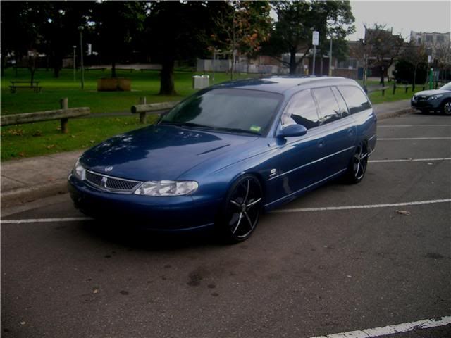

awesome looking ride mate !!!:goodjob::goodjob:

Nothing like a turboed wagon-weapon of choice when it comes to the stealth factor,also good dyno results+track times.Good work Justin/chris,:goodjob:

16-17psi should see you at 700rwhp or 522rwkw given that every psi seems to be adding around 12rwkw at the start and moving upto over 15rwkw based off you figures, these turbo's seem to work best over 12psi so you can jump up quite easily.
hi yeh justin /chris assured this turbo only starts to work at 13+psi just worried about a4 and because im using to get to work for next few months will leave as is for now be interested on figures if it was manual good clutch etc???cheers
Re: my turbo 408 stroker vx berlina wagon
The bros have plenty of experience with these turbo's so feel assured it will do what they say, im yet to push mine due to head gasket issues and because of them my motor is apart again awaiting on new pistons but once its back together 18psi will be run straight through it to see how far it will go.
