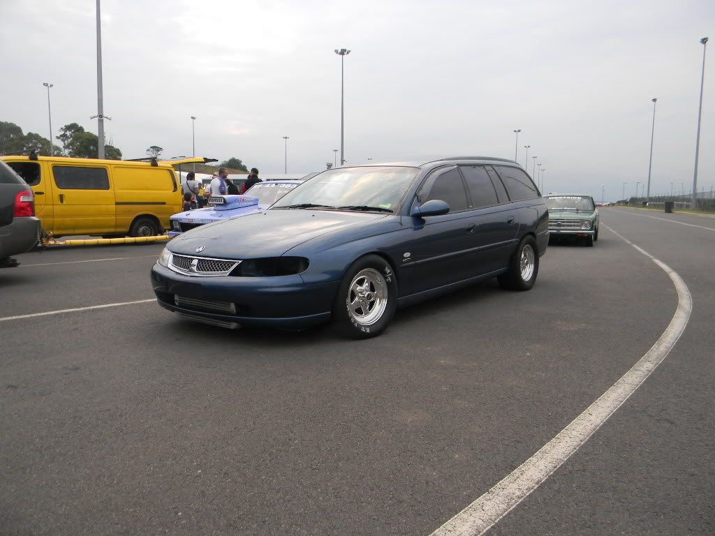

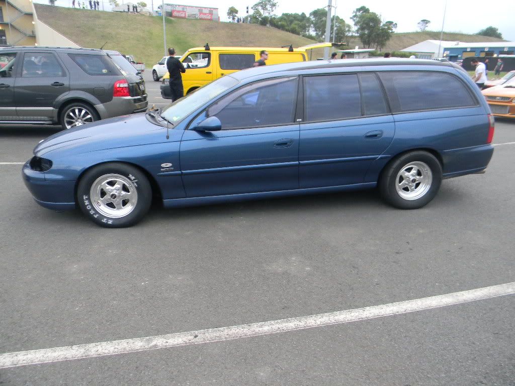

245s may be a touch too wide, i have 235/35/20s and there ain't alot of clearence.
hi mate have run before 245/35/20s and had problems but thru all my research the smaller diameter 30/20s should allow room to standard shock tower and offset with these wheels should be perfect one thing i didnt mention is the only reason i went for the 225s was to act as a bit of a front runna for the drags bit of a toss i know but you get that!!! still yet to decide to remove big brakes and go for a proper front runna combo for the aim of a 9 sec pass????? cheers

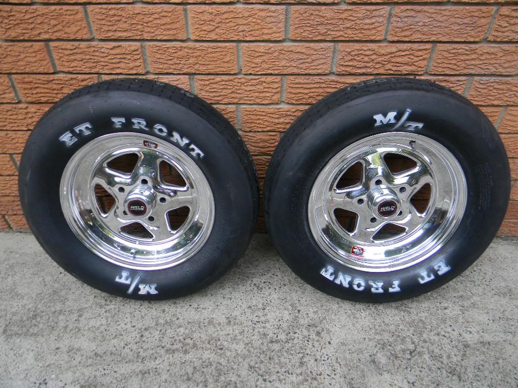

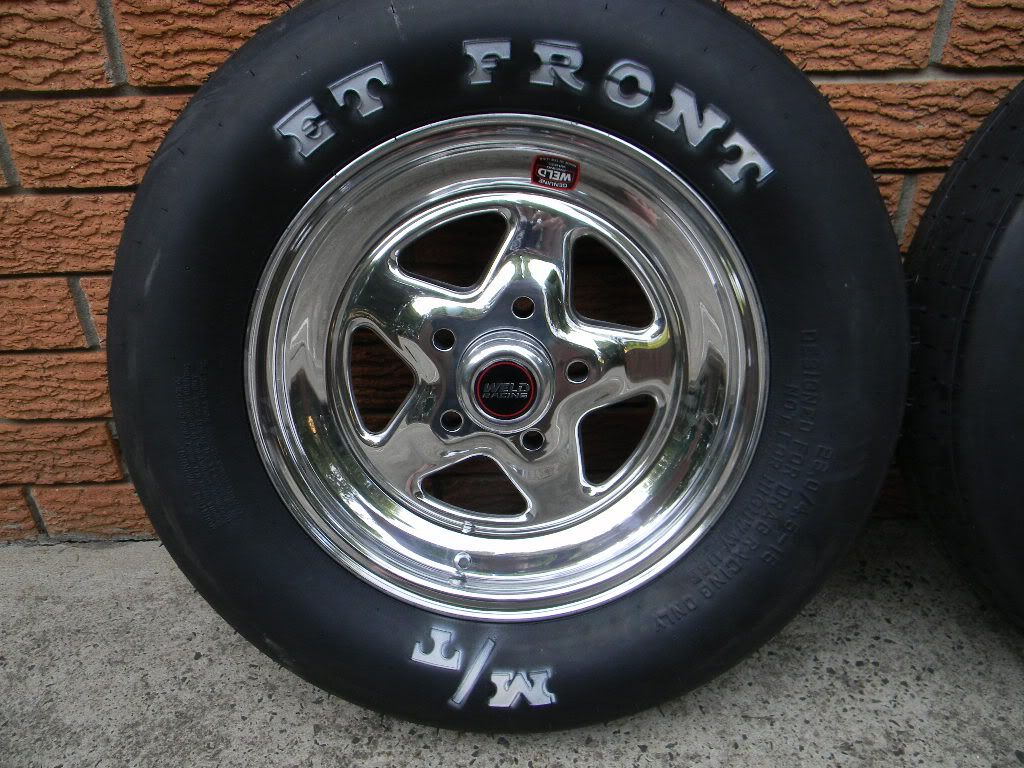

hi decided to bite the bullet bought these today weld prostars 15x3.5 and 4.5inch m/t et fronts and some arp long wheel studs just have to remove big brakes replace with standard slotted rotors that i have sittin in garage gunna run these on front and drag radials on rear to see improvements +/- and yes radials on rear and cross plys on front is andra legal wear out radials then go some full slicks 28x9 or so to pick up some mph!!!!cheers

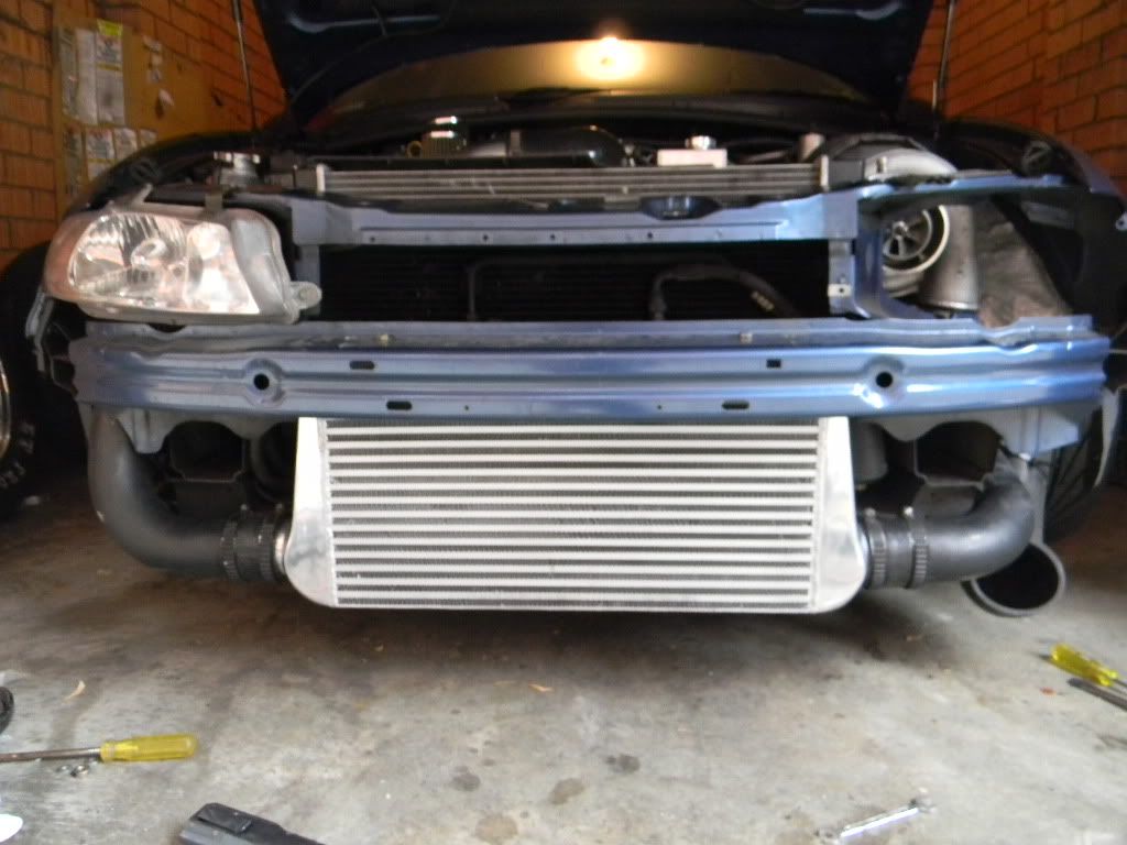

hi fitted new bigger 100mm thick intercooler today to try and help intake temps when boost is wound up!!! went for a spin as is to check hose connections other cars were like wtf haha!!!! cheers
http://i777.photobucket.com/albums/y...n/DSCN0214.jpg
Re: my turbo 408 stroker vx berlina wagon
Looks good mate, did you need to cut the intrusion bar?
SirNemesis
yeh mate it already had 10mm or so cut out had to trim the extra 25mm+ a bit extra for clearance also extra 25mm out of front bar and play with hoses to get them to line up properly!!! cheers
I went from a 75mm to a 100mm Intercooler and it made quite a difference to intake temps, well worth doing.

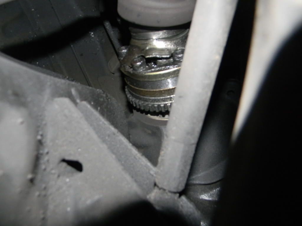

hi fitted stock brakes and arp wheelstuds so i could run the new f/runnas ran the wagon last night first pass @14psi smoked em big time and worst axle tramp ever short shifted 2.4sec 60 ft 12.3 @130mph next run@14psi 1.65 60ft hit 7000rpm went for second huge bang scared the shit out of me!!! $200 tilt tray home!!!shitt happens!!!! looks tuff anyway with the prostars???
http://i777.photobucket.com/albums/y...n/DSCN0219.jpg
http://i777.photobucket.com/albums/y...n/DSCN0220.jpg
http://i777.photobucket.com/albums/y...n/DSCN0223.jpg
ouch..... bad luck mate, is that the only thing that broke?
Still a little bit of metal holding on, could have driven it home ;)
Shit happens mate, good fuses to have, saves the rest of your driveline. Take a spare next time :)
