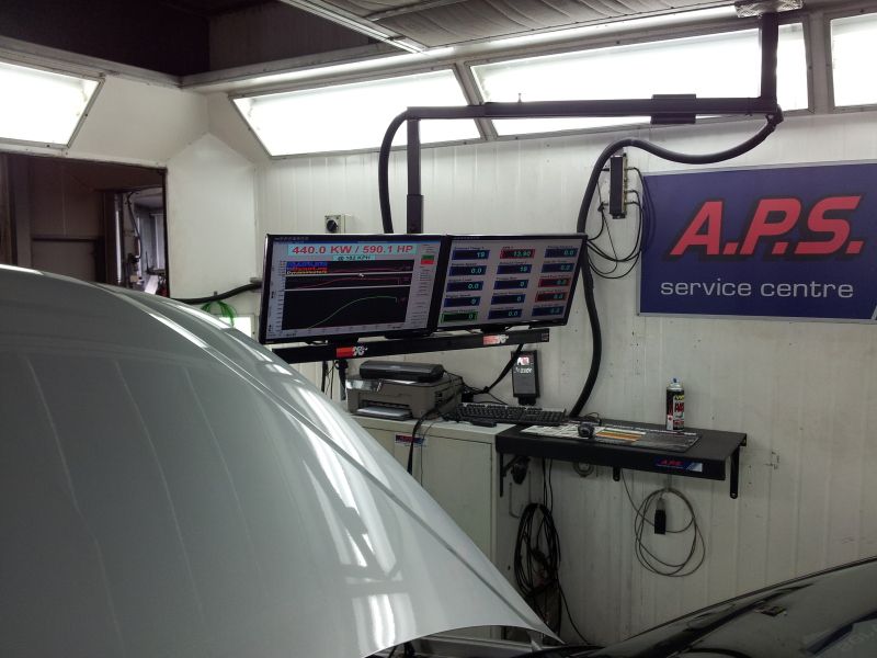

Update! Actuators limited boost to only 10psi, but not a bad result for a 5.7L on BP Ultimate.
It did go 450rwkw but made more torque with less timing so 440rwkw was the end result
e85 on the same boost in the near future, then replace the actuators to run 16psi

http://img.photobucket.com/albums/v9...5-12124912.jpg

What happened to E85 being the devil :P
good result mate
but his worried about it not always be true E85
Even E-flex isnt always spot on
United e85 on all accounts is the most consistent with 81% being the lowest reading I've heard of and 90% (a touch over) being highest.
Caltex blending is pretty average with the same results finding 51% lowest and 73% highest.
With wiring in a sensor it would take the calculation away but on the same note does ls1 PCM support use of flex fuel sensor? Changing tunes at the pump based off pump test before filling is not ideal.
I know Mac but bit of a pita just to run it on the street, 98 tune and e85 for track rather than a handful of altered tables on the v2 and testing every tank you fill
Or carry a water bottle and a test tube in the boot. I'd be doing it for especially as milsys car isn't a daily
