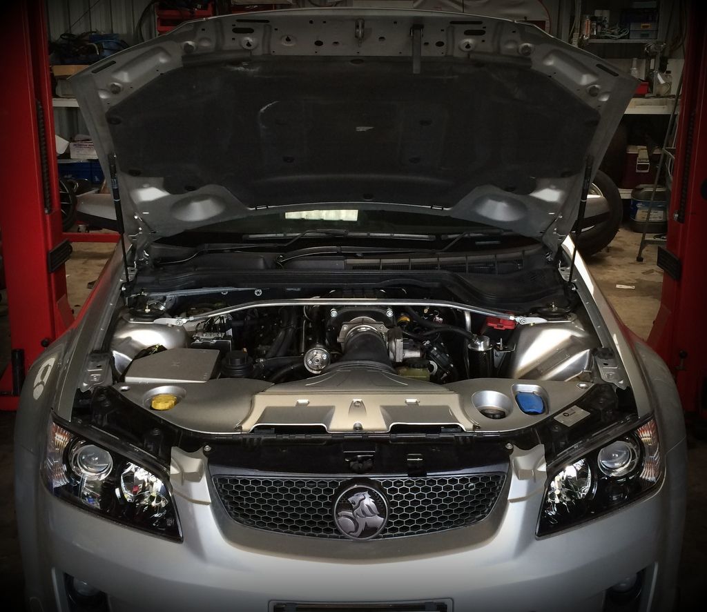

This is mine...
http://i188.photobucket.com/albums/z...ps91cd68bc.jpg
Where do I start , I bought my VE SS new in 2007 as a 6l manual , and from the start I knew I needed some more poke , so I went down the usual exhaust , OTR tune path , eventually realising I needed more Power & Torque.
After 4 years I started on the road to a blower.
I started with an upgraded trans from the std T56 to a TR6060 , a HSV 427 Clutch pressure plate and flywheel
next thing was upgrade the brakes , Harrop monster kit 4 piston front and rear on 355mm rotors. New USA sourced 25% stronger drive shafts.
Next the diff , left the 3.45 gears set in and added a Eton Tru-Trak diff centre , works as an open wheeler normally and applies great traction when needed also able to handle the intended power output
as an extra to this we removed the crush spacer in the pinion and made up a spacer to set preload and stop the crush washer from loosening up with the pounding that was to come. (thanks to TRANSTEER @ Glynde)
Next was a set of Pedder's spots rider shocks and SuperPro suspension bushes to the cradle and trailing arms and sway bars (to help stop the axle tramp).
SO onto the blower , I sourced a Harrop 2300 blower from Harrop with the 8pk pulley upgrade including a 10% overdrive crank pulley and an 85mm blower pulley for 12lbs of boost
also from Harrop a set of long tube 1 7/8th" extractors , a ZL1 fuel pump upgrade (in tank) , a full 3" Harrop exhaust .
From Crane I sourced a cam 216 224 .551 .551 (lift is about .580 with the 1.8 roller rockers) 115 LSA mild blower friendly selection.
also from Crane a set of .600" beehive springs and 1.8:1 Roller Rockers.
This was fitted and tuned at Willall Racing (thanks to Gareth for all his hard work and advice) , the tune up is to be finished this week. (I will post pics and dyno charts l8r)
