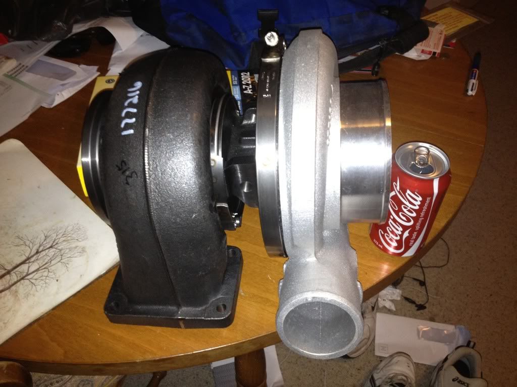

sounds like a killer combo, im looking at the Bullsye unit with there new "BatMowheel" design, 83mm comp 87mm turbine T6 1.10a/r its all ideas right now but will just have to wait and see, Very keen to see how you go with the new turbo and E85, i went from 584rwhp to 625rwhp with pump E85 on the same boost 11psi
ittwgn
hi mate this turbo is a hybrid they use a turbonetics hp-88 mm x 118mm 6 blade wheel they put 91mm wheels in them as well but my research found a better balance between compressor and turbine wheels with the 88 !!! they have also years ago ran garrett 7 blade wheels which were inefficent but still worked!!!! they also have put the s500 88mm wheel in them but lag was terrible with the wheel being heavier!!! running the same 96mm turbine t6 1.32ar !!! anyway should be interesting with some good heads and e85!!! have read good things about the s483 as well !!! plenty of options billet wheels etc etc !!! cheers

Holy crap that is big! What are your new goals to try and run with that?
