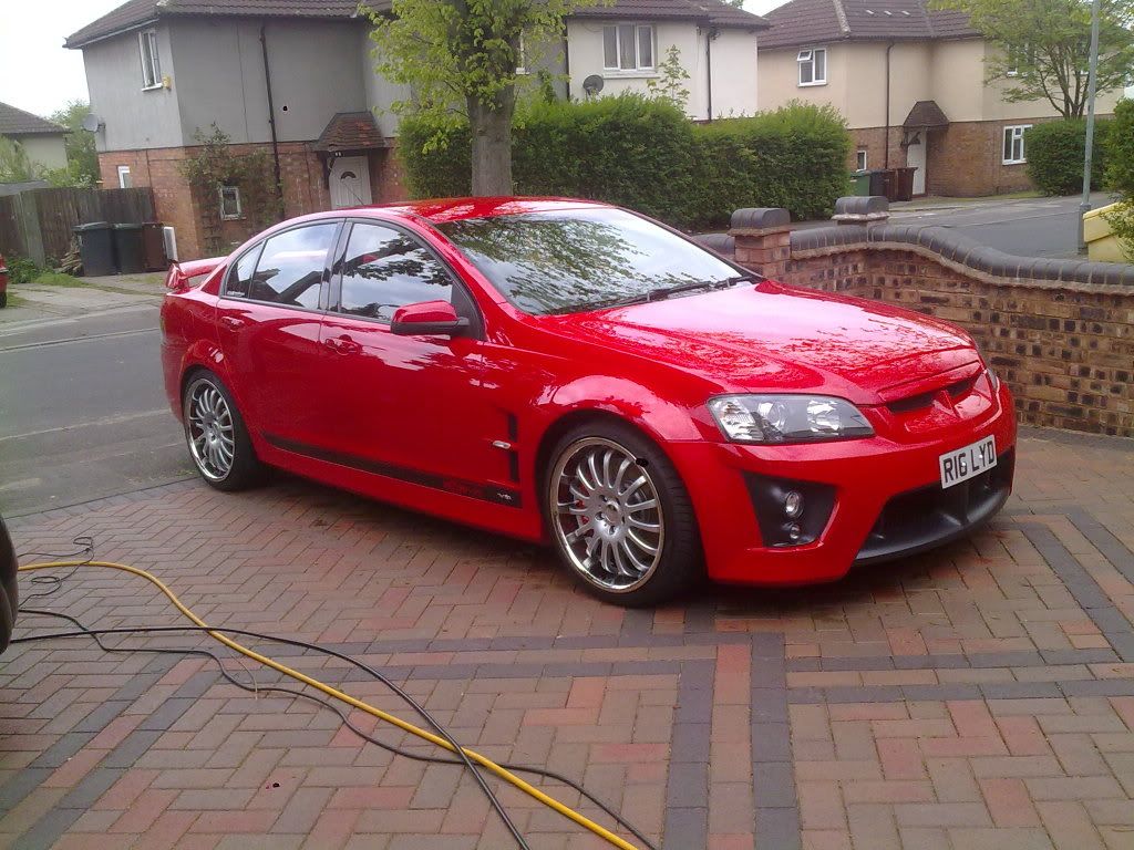

9.5/20 with 40 offset and 275 tyres and if you have people in the back on a bumpy road just catch
http://i577.photobucket.com/albums/s...0052012305.jpg
