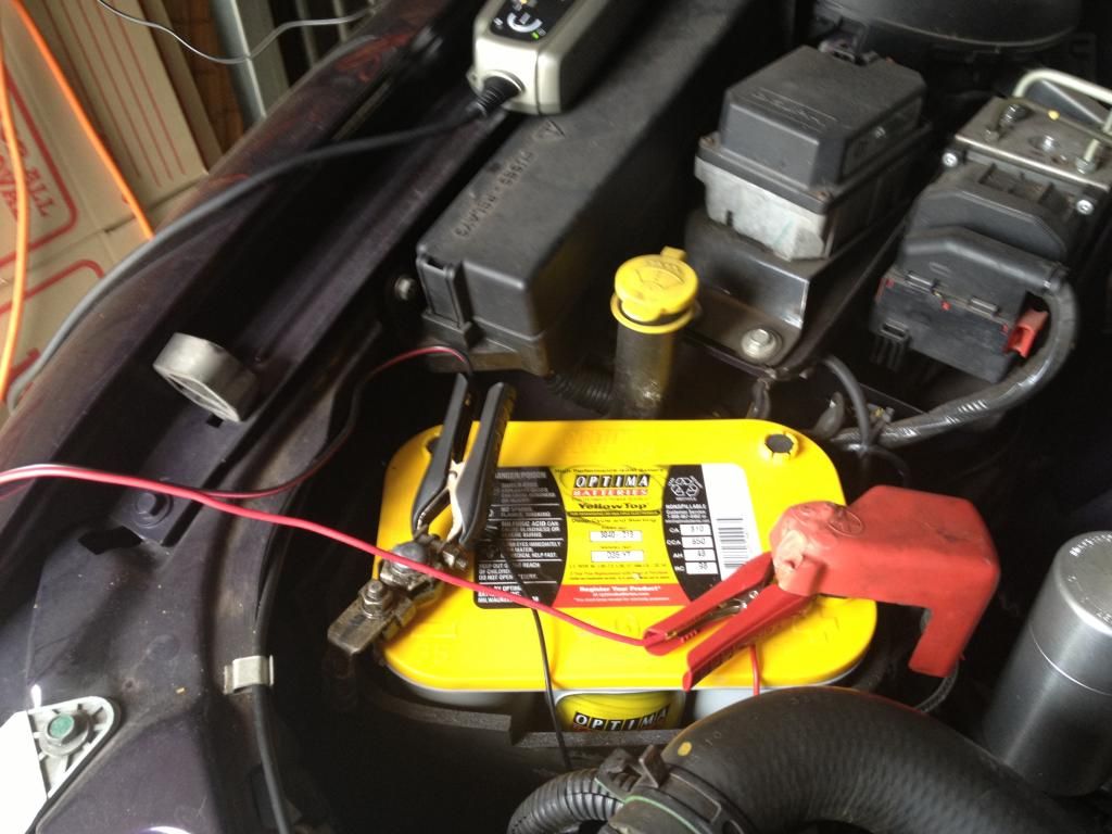

Because I run mine back under the tray on the Tonner and already had eye terminals on my cables I figured stud mounts were easier than clamps or I'd have gone Yellow again!
The 35 (red top) and D35 (yellow top) are a drop in fit VT to VZ , not sure on the VE.
http://img.photobucket.com/albums/v7...ps704bdc14.jpg
I've read that the positive and negative terminals on the D34 YellowTop battery are on opposite sides compared to the factory fitted battery on a VT-VZ. Is it as simple as rotating the battery around 180 degrees so the power cables line up correctly?
Does the mounting plate or anything else need to be modified in any way or does the D34 slot straight in when rotated the 180 degrees?
The photo of the yellowtop on the previous page of this thread shows it to be exactly the same configuration as the century that I have in mine. So no changes required.
Edit: I see what you are saying, the D35 is indeed different to the D34. A quick google search shows the poles to be opposite. I guess it would depend how much play you have in your cables as to whether they will reach with the battery rotated.
Yep - the terminals on the D34 are opposite way around to usual. However, even given the very confined working space the VE ute battery is in behind the front passenger seat my auto elec was able to make the necessary modifications and install it in 10-15 mins. In the WM boot with easy access it should only take an extra minute or two Seldo, or get a D35. Lower CCA and AH ratings but still plenty enough for a car without lots of sound gear or other accessories.
From memory the mods required to make it fit in mine were basically trimming the clamps so the positive lead couldn't short on it. The battery itself went in the normal way so the leads had to be slightly rerouted to reach.
