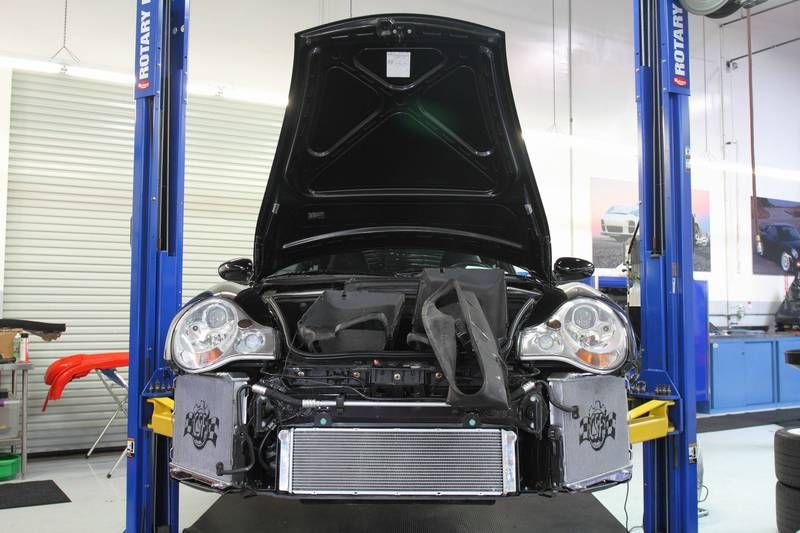

Cooling was my next question, guess they use the standard setup, I couldn't image much more seeing the std ls rads aren't that thick a core, surface area though could be the enemy. However from memory the old mans 911 days majority of coolant and water pipe runs up the drivers side (rhd models) but gauge is small for package reasons.

Being an ex Porsche mechanic, and an LS1 lover, I am pretty interested to see this one finished. I am thinking cooling will be an issue, especially where to mount radiators?

The plan was to run a 996 turbo cooling set up

Yeah "Victoria" runs radiators in the front & has an electric water pump. There is no way you could run a normal belt pump in there. I took some pics/video's when i was over there.
I'll upload some pics later tonight when im at home. The biggest problem it had was engine bay temps when stationary. Once it got going the air temps would drop quick but it was humid as all hell when i was there. Worse then north queensland type humid.
Ill run thermos on the back of the 2 main ones and have run all the time. hopefully that should be enough to keep it cool if not i have room in my wing for an extra one

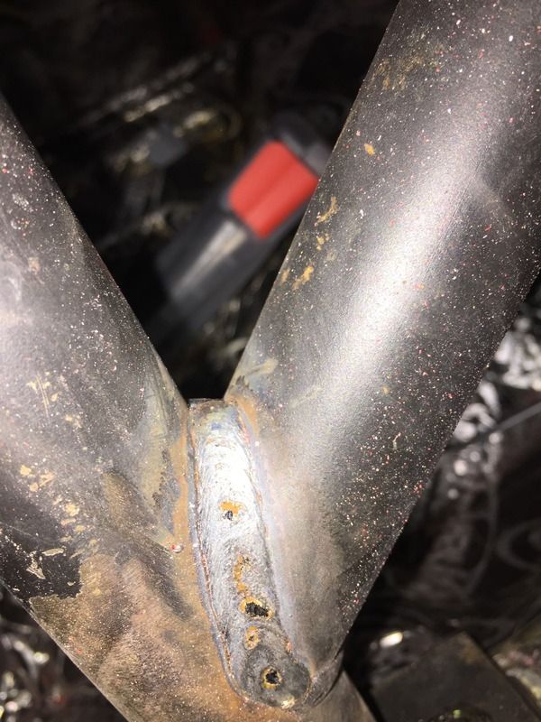

Quick update. Roll cage is finished, car is back to bare metal, new g50 pedal arrived for the hydo clutch needed for the subaru box and next weekend should be in primer. video should be out this weekend and they are slowly getting better so bare with me
Weld quality

JUst needs final welds done on feet and harness bars then off to powder coaters
