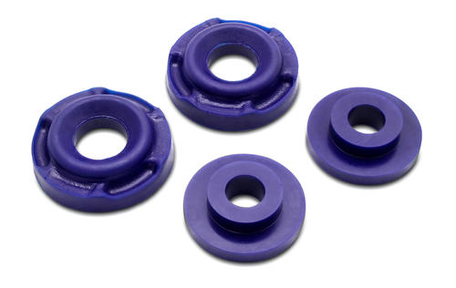

Yes I have seen the Superpro supplemental washers that fit in the OEM Rubber mount (pic below), but I don't know if you'll have the same problem with them not taking up all the free play 100%, like the race mount that I installed.
It says on the Superpro web site for the Supplemental washers, and I quote " To suit OE Bush, HSV series use lower bushing only as factory is solid top "
So HSV's must have a solid Aluminium top mount.

Cheers, good info there.
With the "HSV are solid" quote, I was led to believe they were solid rubber with no voids in them, hence the Superpro inserts are unnecessary
