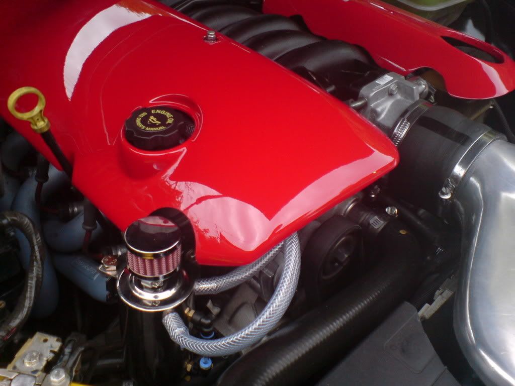

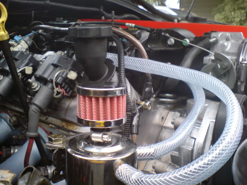

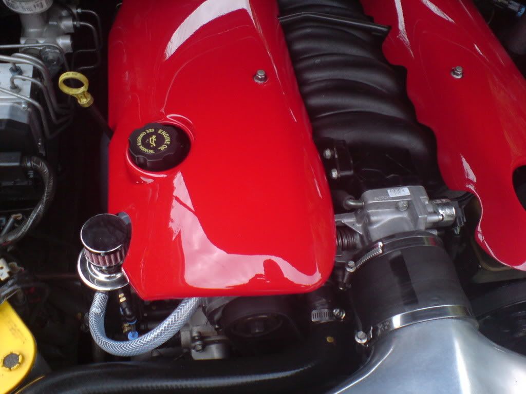

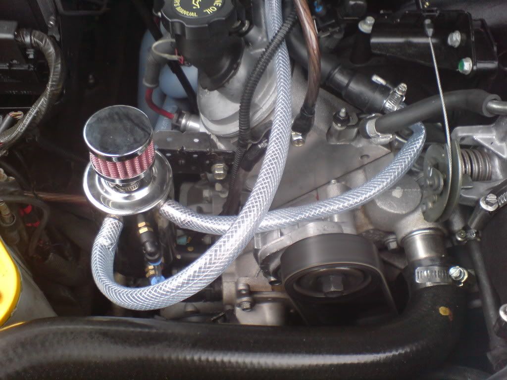

I had some time to install the catch can and things went quite well although i don't particularly like the hose that they supplied so i'll be changing it to something better soon.
Just a question though, as soon as the engine is running there's a tiny bit of visible smoke coming out of the breather, which increases when throttle is applied. Is this oil vapour? Is it normal? I'm kinda worried.

Nice can, Id prefer to have a sealed system ,,,(with no vent to atmosphere). but looks good.
Whats the one from the TB connected to? The low speed draw at the manifold behind the TB is it? but a sealed system wouldn't work the way cbwoluf has it connected either.
Get rid of that crap "braided" hose and use rubber if you don't want it to kink. The stuff that usually comes with these catchcans is crap at best and has the structural integrity of a tissue full of snot.
I'm not 100% on this but I think you've crossed the lines up somehow. The line from the PCV should go to the catch can then into the manifold not to the rocker cover.
http://febs.reddrop.net/car/catchcan/finished.jpg
Venting to atmosphere like you're doing with that catch can will nearly always result in oil vapour coming out thru the filter. This have why you put the catch can in the first place, to catch the vapour. I'm not sure of how significant the visible oil vapour is but if you get stopped and checked by cops and they see it, it will almost certainly result in a defect notice.
Looks pretty tidy though but piss the braided hose of and use rubber.
yes where is that TB line going too? doesn't look right..looks like going below the manifold?
and yes that line is no good, you can see one hose is almost kinked off now. plus will look crappy later after the fumes etc have been going through it.
for vented cans you don't need that pcv valve either it will stop the venting on that line.
The line from the TB is going to the manifold but is blocked off in the middle. So instead of just having end caps, i ran a closed hose between the two so they're not open.
Yeh, the braided hose is really shit. I'll be buying proper hose tomorrow. As for the PCV valve, i tried to remove it, but i couldn't pull it out. Do i have to cut the hose behind the valve or can i actually remove it? And if i have to cut it out, would i just use a double ended barb to extend the hose to the can?
