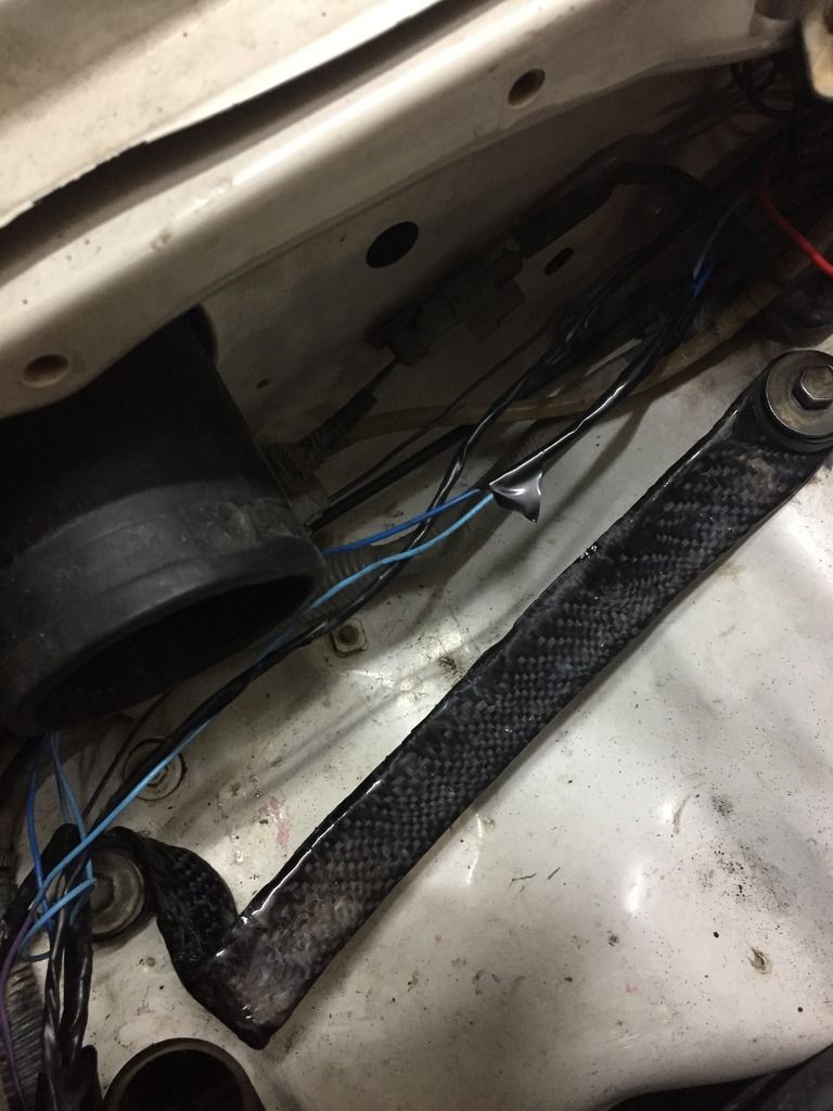

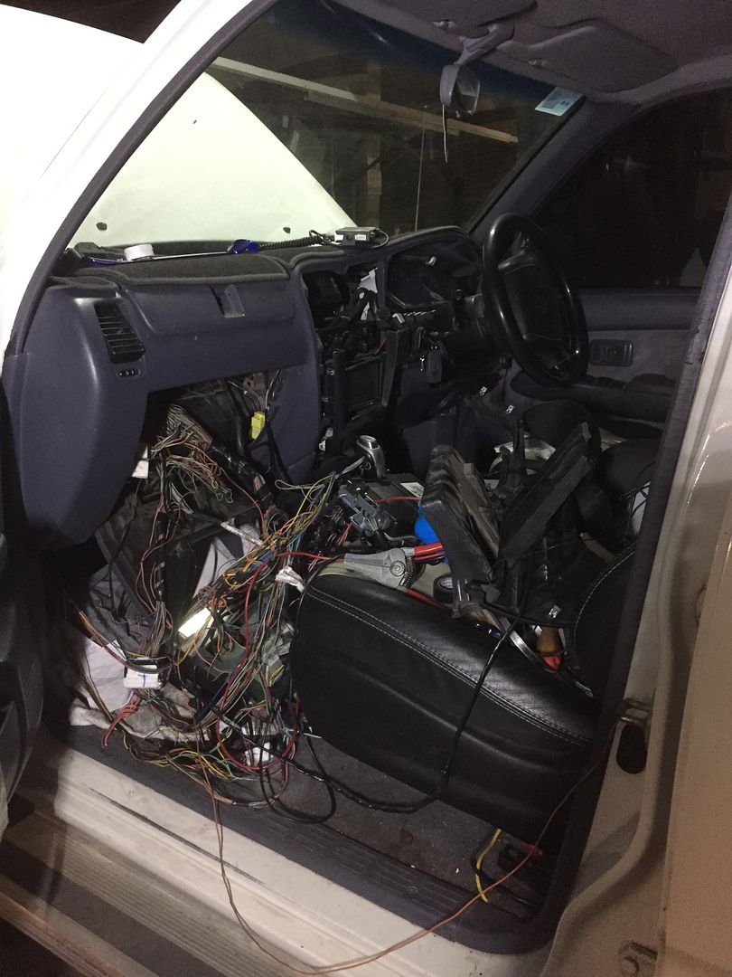

Wiring taken care of... For now. Have rolled it all up and pulled the inside out of the upper glove box. The PCM is in the lower glovebox all outta sight. Need to remove a ton of unused wires then pull the dash out and tuck it up and away in there somehow. Might be quite a few pondering beers that weekend

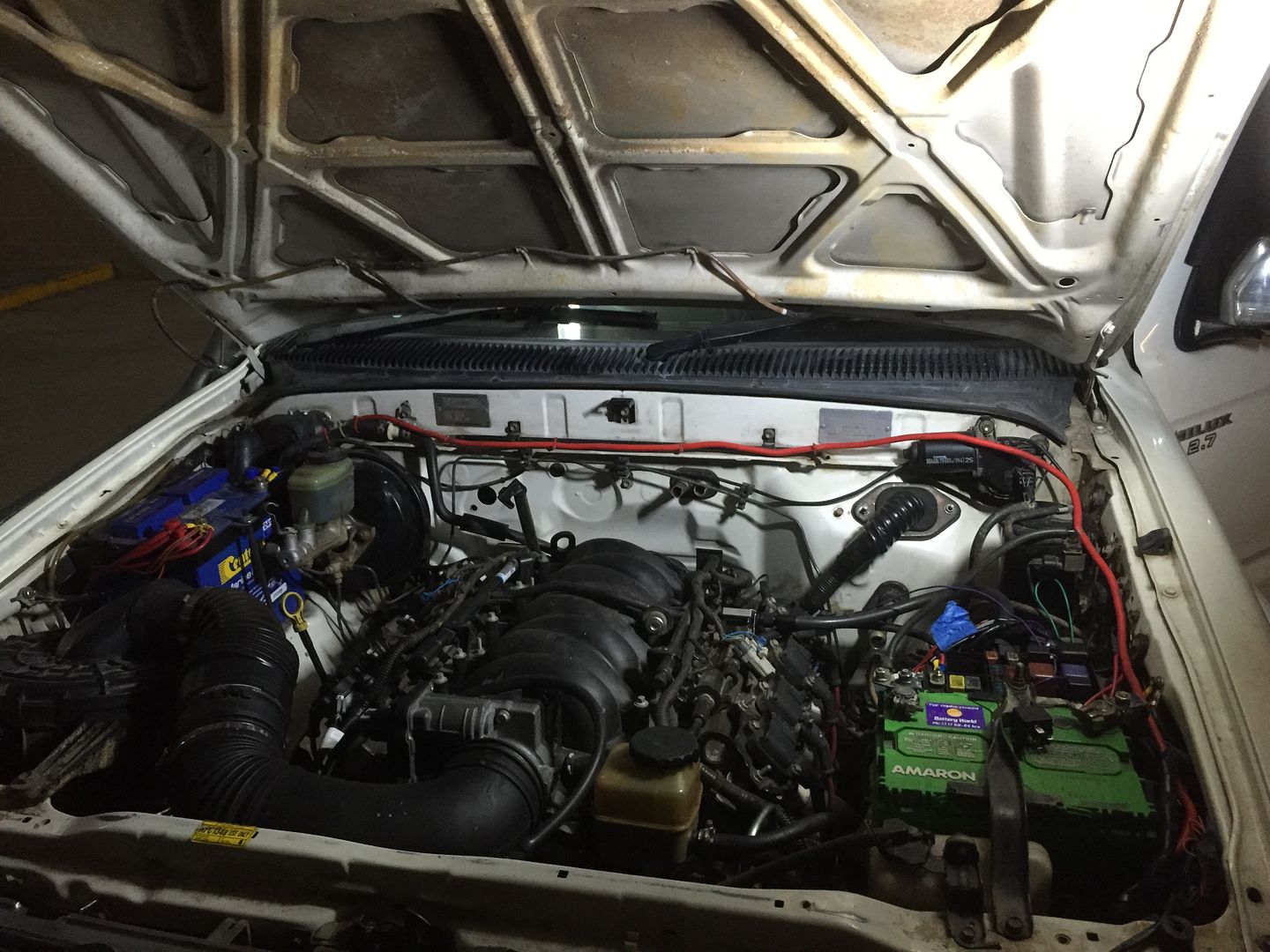

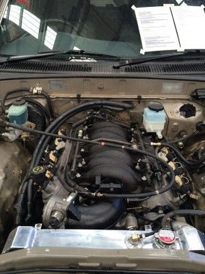

Engine bay is still a bit of a mess. Lots of tidying up to do there. Rerunning 4wd vac lines etc

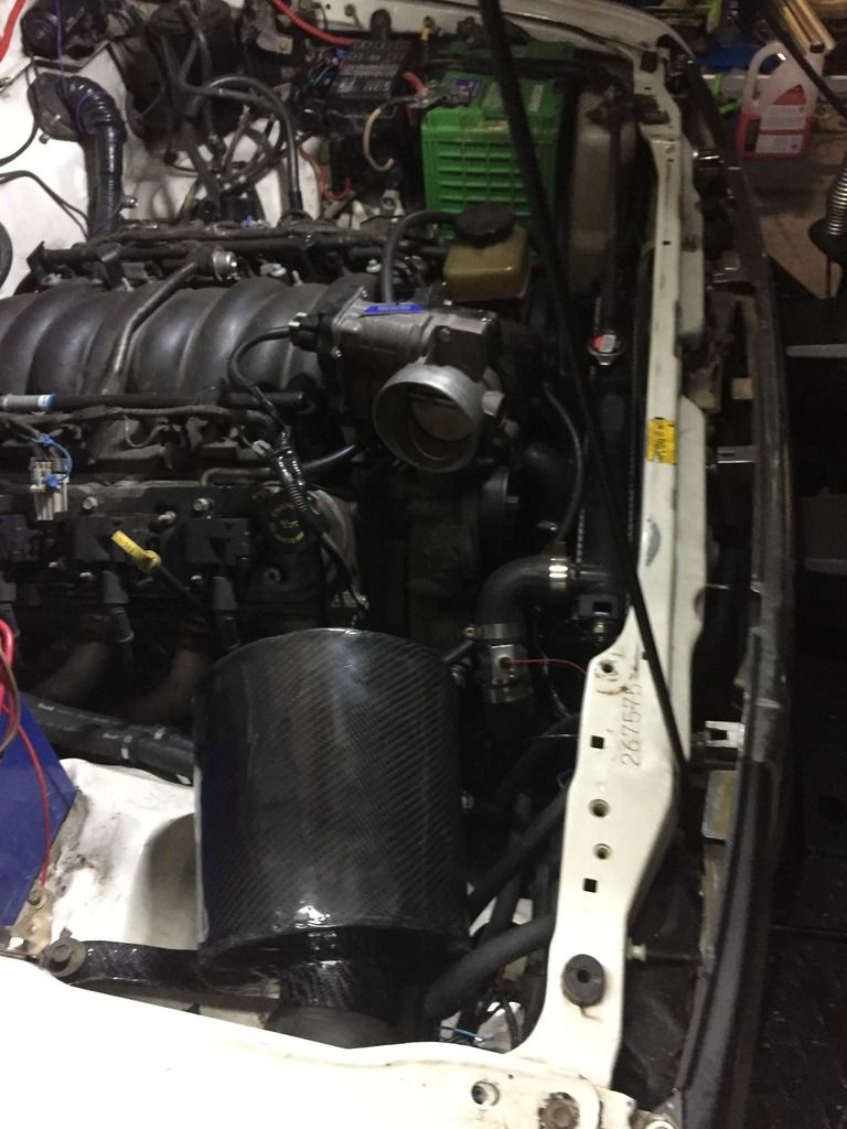

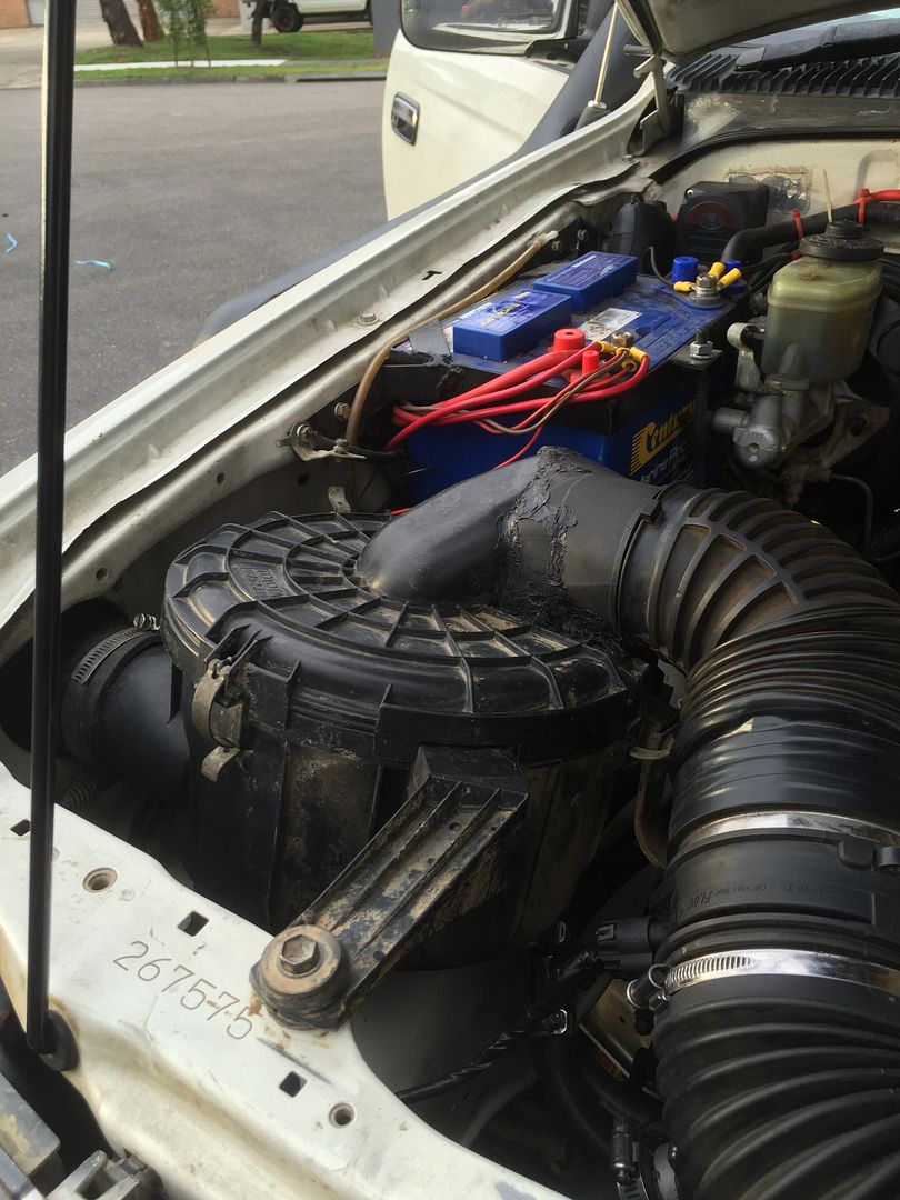

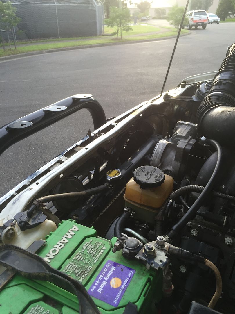

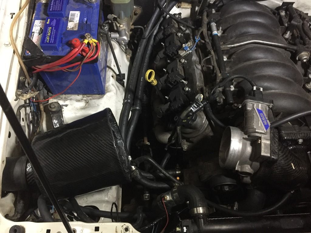

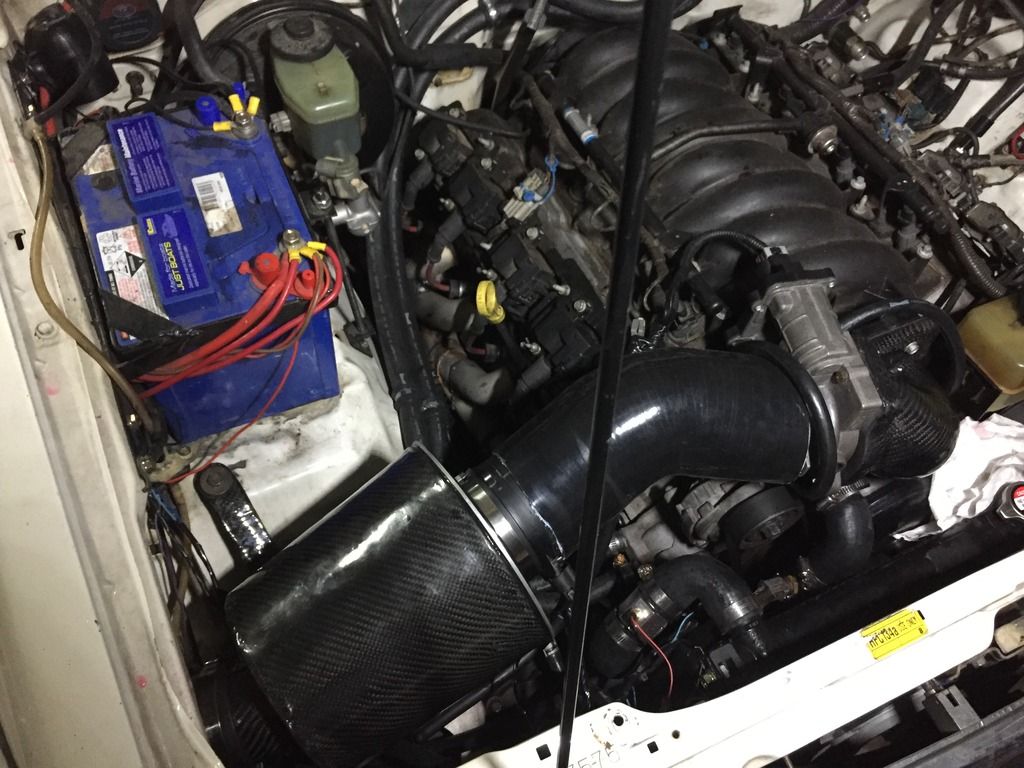

The air box is in serious need of attention. My efforts at plastic welding to the existing box, although totally awesome lol, don't give her the air to breathe when stomping on the skinny pedal. It starves and dies in the ass. Nearly turns the air box inside out in the process.
I am thinking of fabbing up a SS or ally box with big OTR style intake and a butterfly to switch to snorkel when needed.
http://i44.photobucket.com/albums/f4...ps6kyzv6ls.jpg

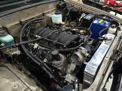

Still to successfully get the stock temp gauge working so flying blind a bit at the moment and making me a little nervous driving.
It overheats sometimes and I thought it might have been an airlock. Lots of bleeding and filling I think I have it but still taking it easy and staying close to home.

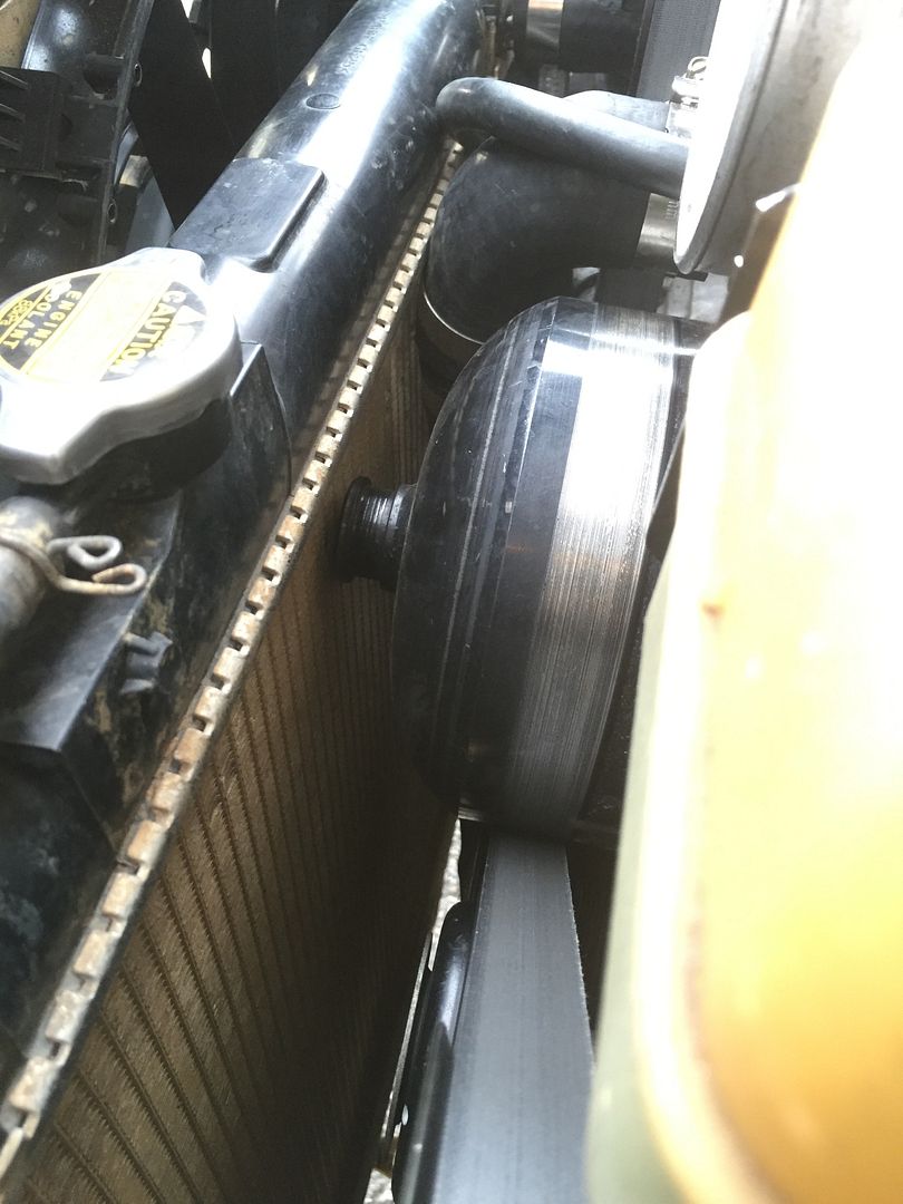

The radiator I had to drop about 100mm so the intake could fit on. Not sure if having the radiator so low could be causing some issues there also.
http://i44.photobucket.com/albums/f4...psok1odco1.jpg
Clearance is pretty tight so don't have much room to move things around down there.

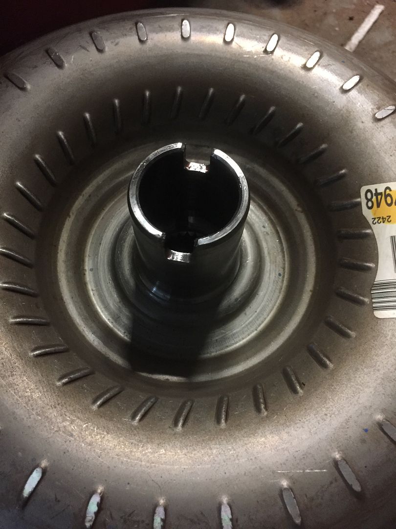

On way back I pulled over to double check and went to put back in D... Nothing. WTF!
Turns out you need to put the torque converter in the bell housing when mating it up to the engine and not the other way round.
Result...
http://i44.photobucket.com/albums/f4...psffzevnfu.jpg
Now back in the garage and attempting to pull the box out from underneath to swap out the oil pump.
Note to new conversionists, put the torque converter on the bell housing first.

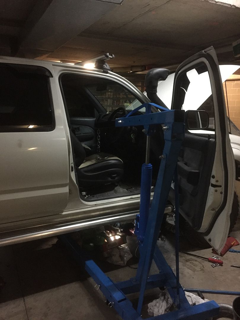

Well gearbox is out and it's only 245am, easy done.
Would have been so much easier to do with engine, box and Tx case on the floor.
Those torque converter bolts were a bitch. The plastic cover around starter wouldn't come off and wasn't able to get the starter bolts off. Had to drop the sump and access it through the crack with 4 extensions and a socket.
There were 2 bolts on the Tx case that weren't accessible so the whole lot had to come out in one piece. Had the floor crane through the shifter hole and a jack under the sump. A shit load of wiggling lifting pulling grunting cursing and beers we got her out.
Not looking forward to the install.

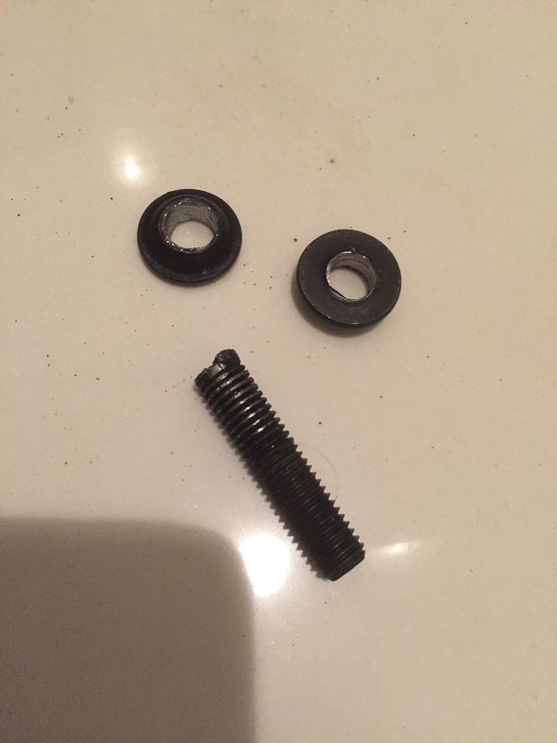

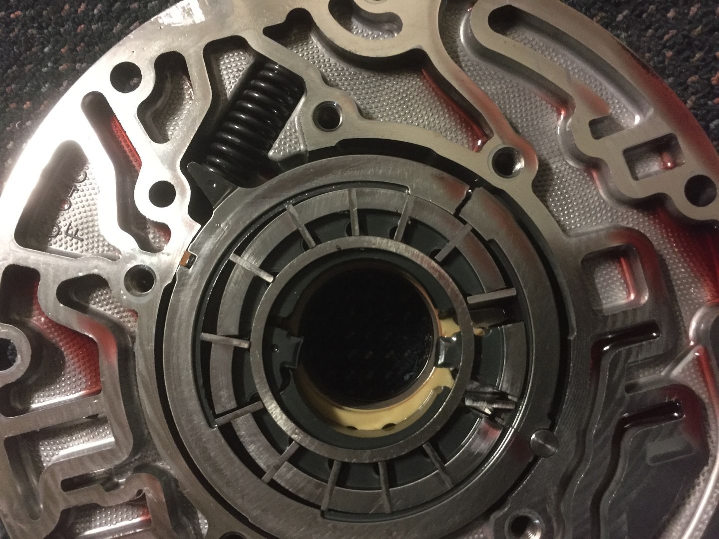

Here is Camos rooted oil pump. He is now noting the 2 broken tabs and see where they locate into the notches in the TC
http://i44.photobucket.com/albums/f4...psz7clwh0l.jpg
http://i44.photobucket.com/albums/f4...pst9mskd6d.jpg
Been speaking with a transmission guy in Girraween who has been such a help with getting the girl back on the road. Vey knowledgable and wish I had the same conversations prior to doing the work. Live and learn though.

Picked up the parts today and raced home to continue operating on the girl. Pulled an all nighter finishing at 5am when the alarm went off to get up for work. All done and dusted, ready to take to work.
Only problem is didn't have enough O pos to fill her up :cussing:
Going to steal the Mrs car, going to be pissed about walking the kids to school after coming off night shift
After topping it up with oil she's as angry as ever and back on the road, very happy bowt that.

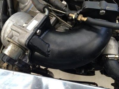

I'm now planning to lift the radiator and make an air box so did some googling for inspiration and came across an ls1 Hilux.
The throttle body was bolted to a 90deg elbow so it came out to the side rather than facing forward and using the bent intake pipe.
This put the bend at the intake manifold rather than 20-30mm after the throttle body giving significant clearance at the front. Every mil counts :lmao:
The donor car worked for marks and was an R&D project for future kits etc so I called and said it wasn't something they went on to manufacture but had one on the shelf. Was after $325 ish for it and I politely declined. Anyone know what this part is called and where I might be able to source at a more reasonable price?

I was looking at the Edelbrock elbows. They are for a carby intake to mount an Ls TB onto but was going to try to modify it. The TB is a 3 bolt and looks like it has a few bolt hole patterns on the TB side. The manifold side is a 4 bolt and might be able to be modified to work.

This is my current setup with the existing air box
http://i44.photobucket.com/albums/f4...pscuzijqez.jpg

What's your idea for the Rad fix?
It drove fine into Sydney this morn and over heated while parking with the expansion tank bubbling away like nannas kettle. Seems to be fine while driving along at speed with more airflow. The throttle position could have something to do with it. Will refrain and take it real easy for a bit, just so hard to fight the urge to hear that growl.
If I can move the throttle body I can lift the rad back up and the fan will cover better and be more effective.
Will then sort out a shroud and may even put a second fan on.
I have the fan on a relay that comes on with ignition and stays on the whole time. Just until I get it sorted and are confident the PCM will trigger the relay when needed.
My boggle at the moment is that the old temp sender I put in a sender housing like a radiator hose joiner and wired it directly up to the gauge.
When the thermostat opens and warm water starts to circulate the needle moves up to where it should. But it does t move higher than that. When it over heats you would expect the needle to point high but doesn't.

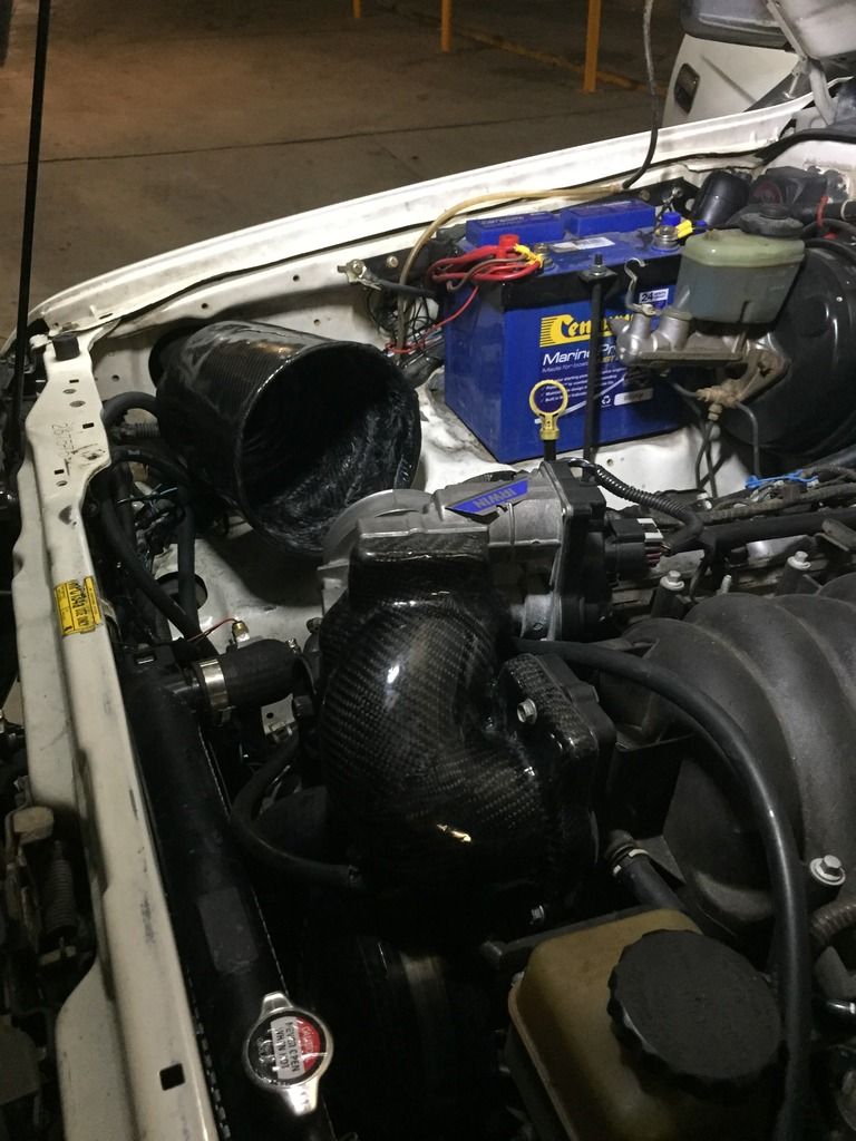

Started making up an adaptor to relocate the TB.
Used a spacer as a template and used plasticine and formed over the spacer.
Then poured cornice cement over and pulled out the plasticine. Then used resin and fibreglass mat to create the flanges. Sorry didn't get pics of this process.
I used a length of pbc and filled it with expanding foam and then the old pie cut trick to get the bends how I wanted.

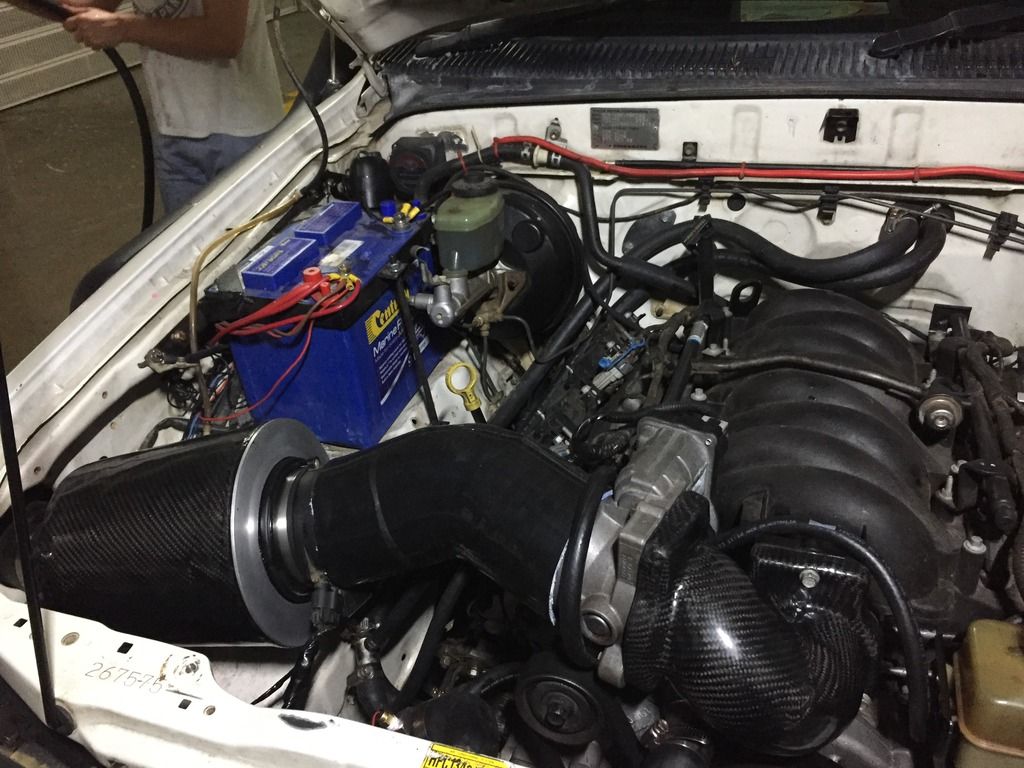

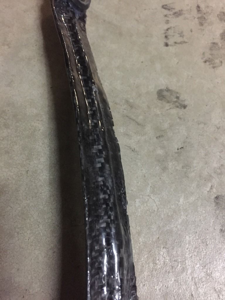

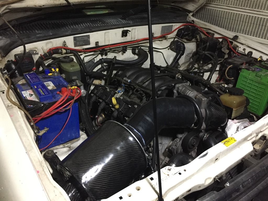

Started wrapping in carbon fibre. Not as easy as first thought, but then again it's a fairly complex shape for a first attempt... that's how I roll
http://i44.photobucket.com/albums/f4...pshrbyxcul.jpg
http://i44.photobucket.com/albums/f4...psj184xk5p.jpg
Geez....:shock:
You are not shy to have a go at making things yourself mate! :goodjob:
Final epoxy coat on the adapter. Came up really well and happy with the result.
The air box in the background had a little bit to go and will be ready for the weekend
http://i44.photobucket.com/albums/f4...psliaeivvj.jpg
Final coat on air box, finally. Need to weld up the end cap and polish. Looks a bit ordinary in the pics when wet with light reflecting off it but really looks the goods.
The inlet pipe is offset to line up with new position of the TB.
http://i44.photobucket.com/albums/f4...pspt70rtme.jpg
It fits and the bonet even closes :yahoo:
http://i44.photobucket.com/albums/f4...psbnhhefe0.jpg
http://i44.photobucket.com/albums/f4...pskgxsiczi.jpg
It certainly doesn't look outta place! :thumbsup:

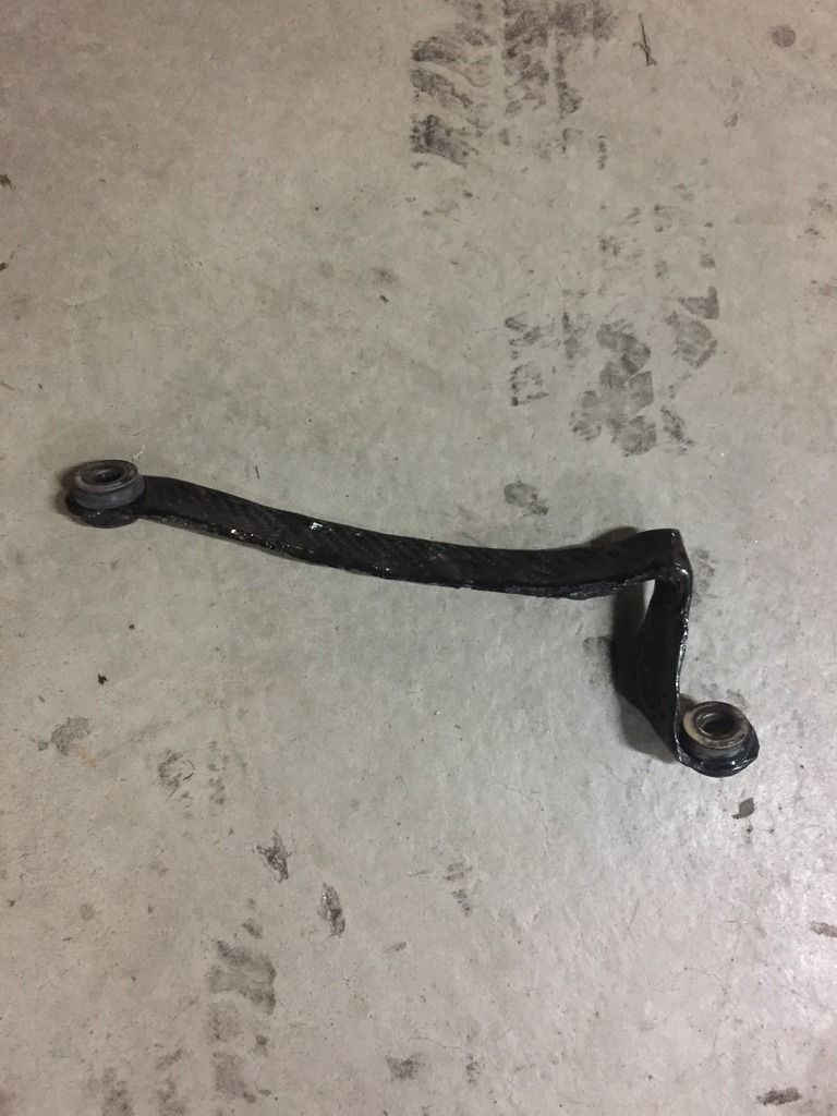

The air box bracket to use existing bolt holes
http://i44.photobucket.com/albums/f4...psg2rmnmhc.jpg
Ran a bead of silicon on the first layer, then put 2 more layers over top. This gave a ridge down the length and added a shit load of strength.
http://i44.photobucket.com/albums/f4...psgicz45yb.jpg
http://i44.photobucket.com/albums/f4...pslzw6nc51.jpg
Next is the air box for the pod filter. Polishing up end plate tonight and will mount the MAF on the pod and join to TB with sexy silicone hose.
That is unless any other suggestions come forth.
I was going to make up a carbon tube but though might be too much.
http://i44.photobucket.com/albums/f4...ps3hszxgxm.jpg
http://i44.photobucket.com/albums/f4...psttpupzmc.jpg
http://i44.photobucket.com/albums/f4...pswixhumup.jpg
Still needs a bit of tidying up but this is the general idea.
http://i44.photobucket.com/albums/f4...psshr7rwt8.jpg
http://i44.photobucket.com/albums/f4...psjeaa0khx.jpg
http://i44.photobucket.com/albums/f4...psrtkix2xe.jpg
Looks brilliant Cam! Probably a lot safer than it was too. :thumbsup:
