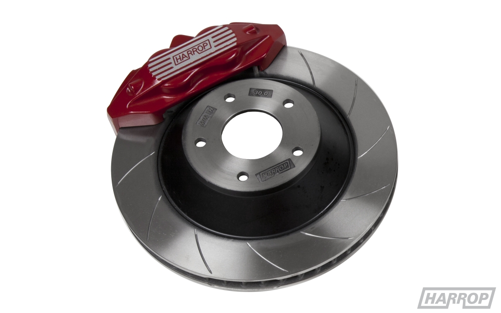

These are the brakes I am looking to purchase. I think 1k is a pretty good price? Still not sure if they will fit under my rims though.

These Harrop "Front Only" Kit 343mm X 32mm / 4 piston calipers say and I quote " A minimum of an 17” wheel diameter is required - Caliper sweep template is available above in the download tab to check specific fitments."
https://www.harrop.com.au/shop/image...-1000x1000.jpg
https://www.harrop.com.au/shop/products/brakes/performance-kit-front-holden-vt-vz
Pricey @ $2,420.00 just for fronts, but they may fit your 17's, and a rear upgrade is probably not required, the fronts do the vast majority of the work anyway.
$4400 for the whole kit, and it says the same line "A minimum of an 17” wheel diameter is required - Caliper sweep template is available above in the download tab to check specific fitments "
