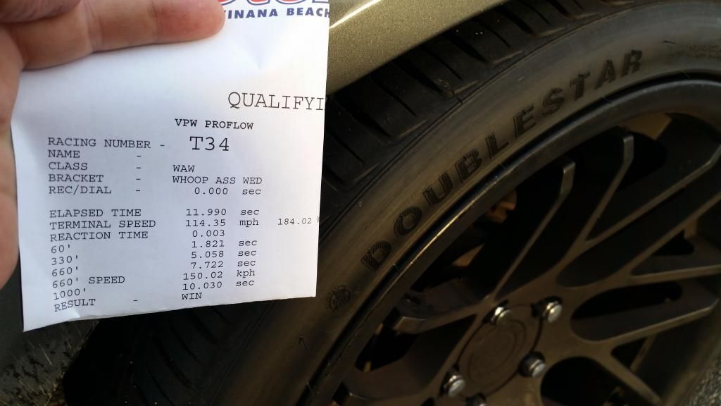

I figured on Wednesday I would give street tyres a shot at the Motorplex. Cheap and nasty Doublestar 275/30 R20`s and ran 11.990 first pass
http://i188.photobucket.com/albums/z...112_181216.jpg
Thats a good 60 foot time for streeters,well done
