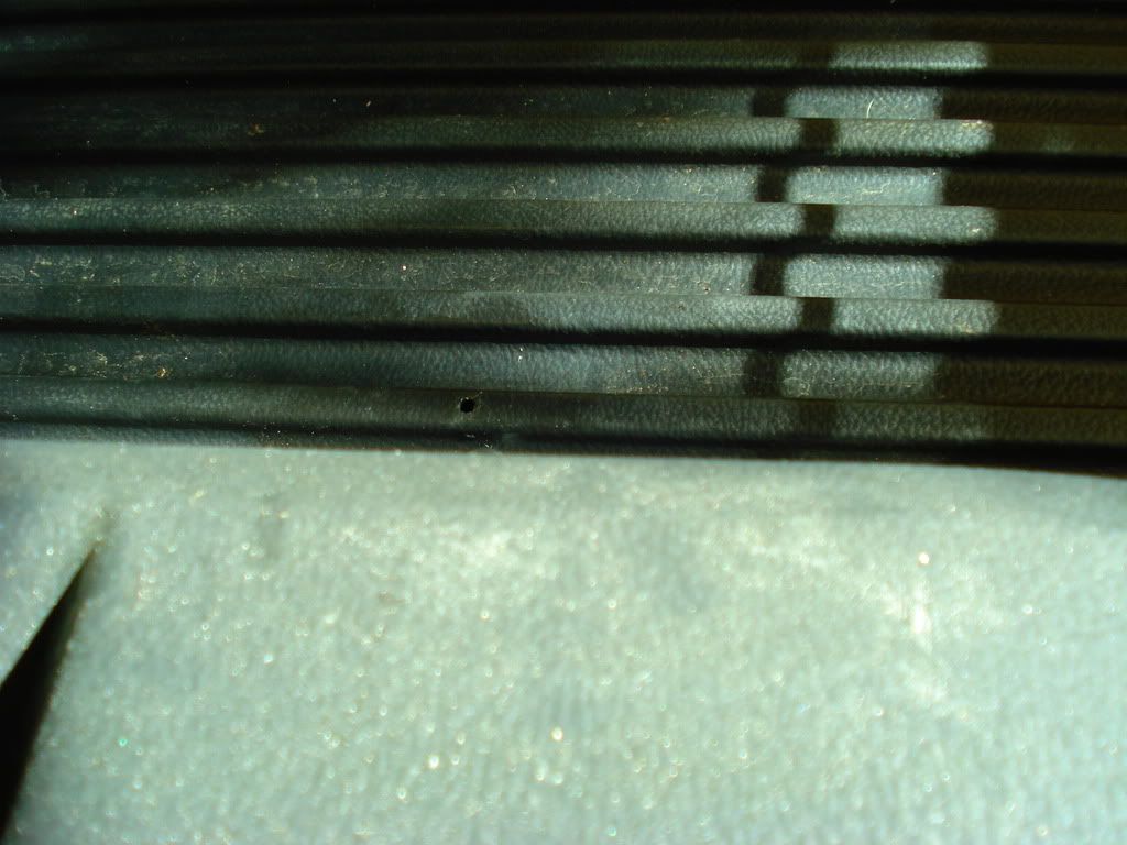

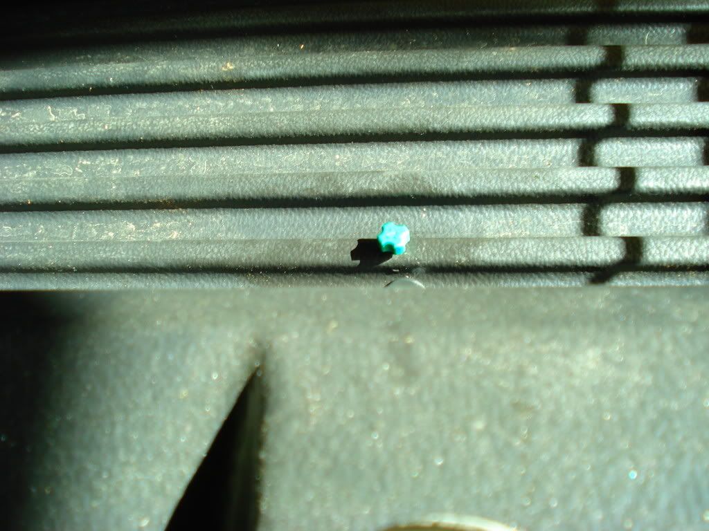

on mine there is no thread showing at the bottom of the tube i have 100 mil ground clearance :)that was until i put the 3" system on :bawl if you wont to drill the holes in the liner it is very easy as it is only thin plastic i did mine after fulcrum fu*&^^k it up

great ride round town:) but will bottom out on the hiway on the front (even on hardest setting ):bawl:so will be geting stiffer springs fitted on the front before i go down to bris again nearly lost my false teeth last time :)there is a few post on here about drilling the holes in the liner with measurements

Just spent the day, giving the ute a good drive.. Totally unimpressed with my new setup..So bad I have a sore back.. I have the fronts set to full soft and the backs, well I have no idea but I'd say they are set to full hard.. Yesterday I pulled the tray liner out to adjust them but found there was no hole to access them as I was told there was by Fulcrum.. So Cant get to them..They gave me a photocopy of the instalation page and it said that you need to drill the hole before the struts are put in.. So looks like I have to go back again:vpo:.. I cant beleive how rough they are.. I thought my last car was rough but this is insane..Turned a car I didnt want to get out of into something that I dont want to go near. If it doesnt improve when the rears are on soft Im going to put the stock suspention back in.

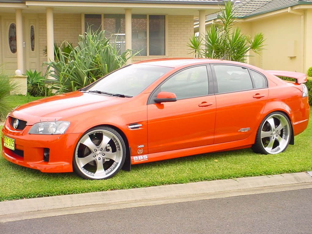

here is my VE SS sedan with the king springs and different bump stops front and rear ...the ride is fantastic now and it has 22" wheels...you should have taken my advice mate...
now you have to start again....i also have the tein coilover shocks in my 350Z with king springs fitted...both these cars handle and ride beautifully..

Had the ute back to Fulcrum yesterday..Had them cut the holes in the tray so I can adjust the shocks..Have them now full soft front and rear..Also had the front height raised 5mm to try and stop the banging.. Havent had it out for a good drive yet but.. In the wash up so far..I have a ute that sits nearly as high as it was stock handles only a bit better than stock but still bottoms out and hits the bump stops all the time...So my $2500 investment has still yet to prove itself.. I want to make them a bit harder, but will have to see how it goes..I'm driving down to Indy tommorow night till Monday:headbang::yahoo: so hopefully I can have a bit of a good go with it.. Have only really driven it home from Fulcrum so far..... Will post how I go when I get back from the coast...

loudyeller i gave you the answer to your problem before you even fitted them....it is way back in post #5...you car will still be the same mate...why didn't you get the king springs fitted to the shocks before you had them fitted....change the springs and bump stops ..all will be good...

Had a great time down at Indy..The car drove great down and back..Had it on full soft and was pretty good..Still hits the bump stops really hard sometimes...Ive wound it onto 9 clicks from hard.. still pretty rough around town but its as good as its going to get with out forking out more ... Ignition, how much did the king springs and the new bump stops set you back?
