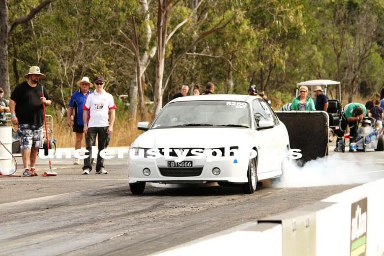

got some pics from unclerustys photos and insane grunt.

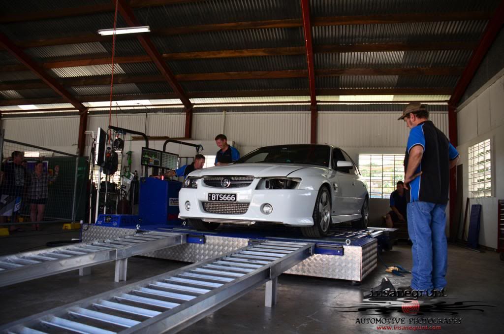

the car on the dyno at the insane performance open day. check out insane grunts website and you tube channel for pics and vids of car stuff from central queensland and up and down the east coast.

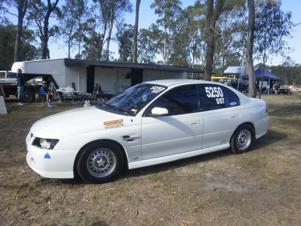

these are from benaraby in march.

for those that dont, its a quick vid of the car on the dyno. made 568rwhp, with 1200+nm of torque. :)

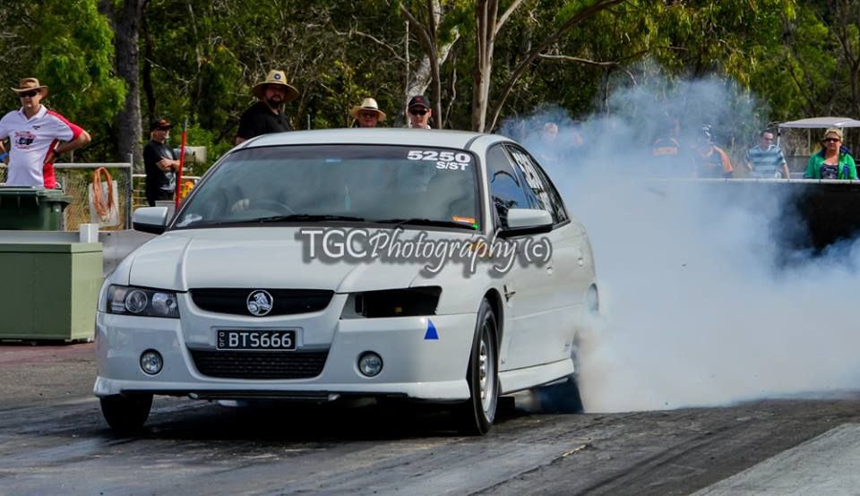

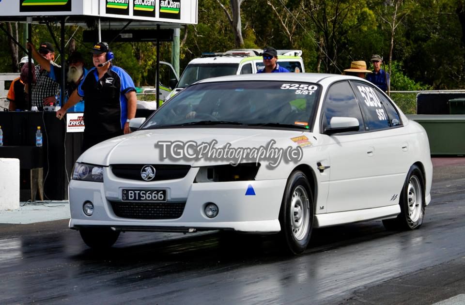

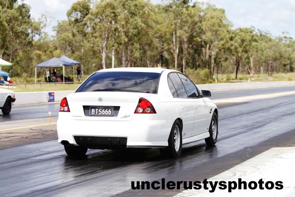

a few pics from the aeroflowround, courtesy of tgc photography and uncle rustys photos :)
http://i741.photobucket.com/albums/x...ps1eca1ba8.jpg
http://i741.photobucket.com/albums/x...pse7e955c9.jpg
http://i741.photobucket.com/albums/x...ps4efeba00.jpg
http://i741.photobucket.com/albums/x...psa683d990.jpg
http://i741.photobucket.com/albums/x...ps3a744266.jpg
its me, getting a trophy :)
http://i741.photobucket.com/albums/x...psfdae7515.jpg
http://i741.photobucket.com/albums/x...ps7c3046b7.jpg

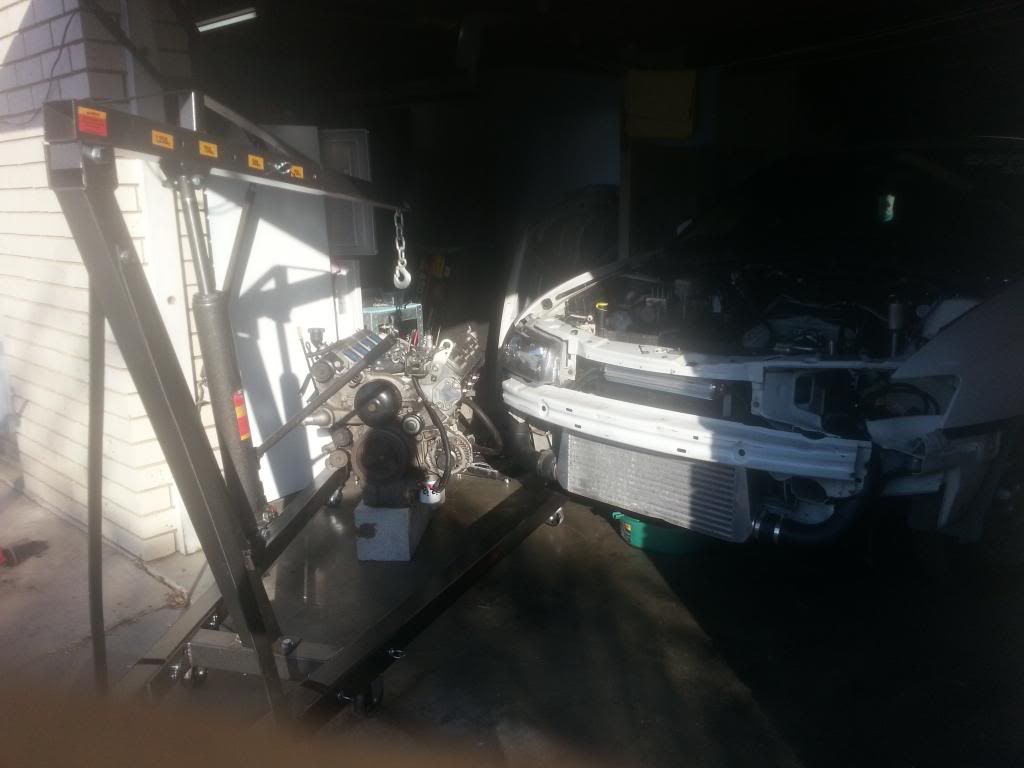

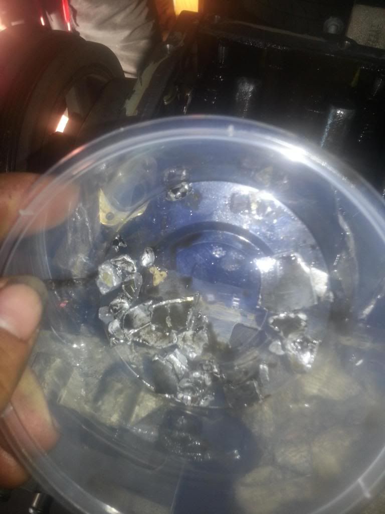

well, zane from insane performance came around, and we put the arp studs in, with new gaskets. he also did the trunion upgrade for me while i was at work. after he torqued down the studs, i spent the next few hours reassembling the rest of the thing, turbo exhaust, etc.. on friday, discovered that the radiator was stuffed, so the guys at insane sourced one in about 20 mins, stuck that in, refilled it and put it back on the dyno for a run. was ok at low speeds, then when zane went to do a power run it coughed and spluttered, , long story short, a compression test shows that the rear 2 cylinders are significantly low on comp compared to the other 6. pretty sure its just the rings from being overheated last month. the motor is coming out next fortnight, i'll throw it on a stand, and Zane is going to help me pull it down, if it is just rings, we will deglaze the bores and replace rings, i will drop the psi down to 9 or 10, as i dont think 12 was helping, and should be racing at the october meet for my birthday . if it is a bit more serial, i will be getting a cast iron block and 402/3/8 ci stroker rotating assembly and using the heads and accessories i have. the fiance says we will be racing by february if this is the case awesome woman, thats why im marrying her next week..
pretty bummed out, but at least i didnt kill it completely, or drop a tonne of metal and oil at the track and possibly ruin someone elses day.

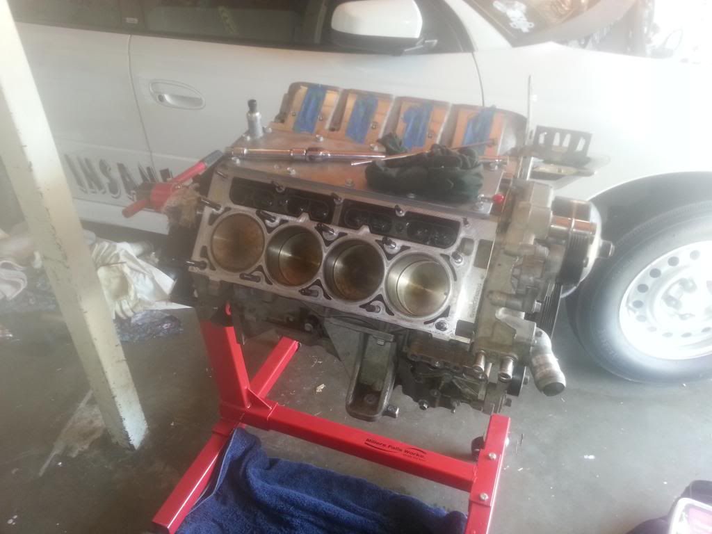

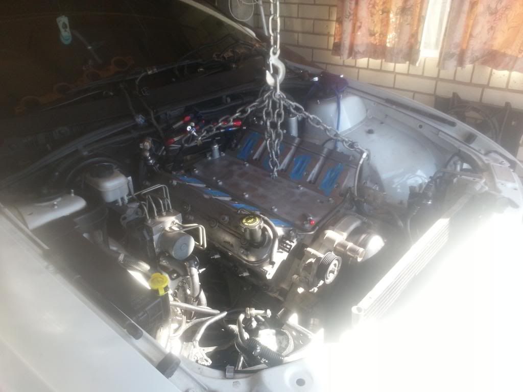

motor is out. did it all by myself, in the garage. :) yay for me.
http://i741.photobucket.com/albums/x...psc6555663.jpg
then found out need some longer bolts to bolt it to the bloody engine stand. i thought the tranny bellhousing bolts would have fit, but they are about 2inches to short. so its sitting on some bricks till i go to the bolt shop in the morning.
http://i741.photobucket.com/albums/x...ps6ae017b5.jpg
i didnt even scratch anything getting it out.
lightened a piston by breaking it into smaller bits
http://i741.photobucket.com/albums/x...ps090720b2.jpg
bent rod, broken piston.
http://i741.photobucket.com/albums/x...psa49777e1.jpg
yay, look what i found :)
http://i741.photobucket.com/albums/x...pscf662d7d.jpg

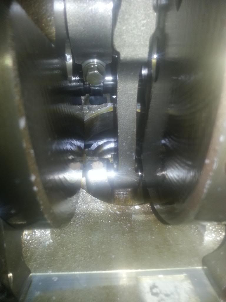

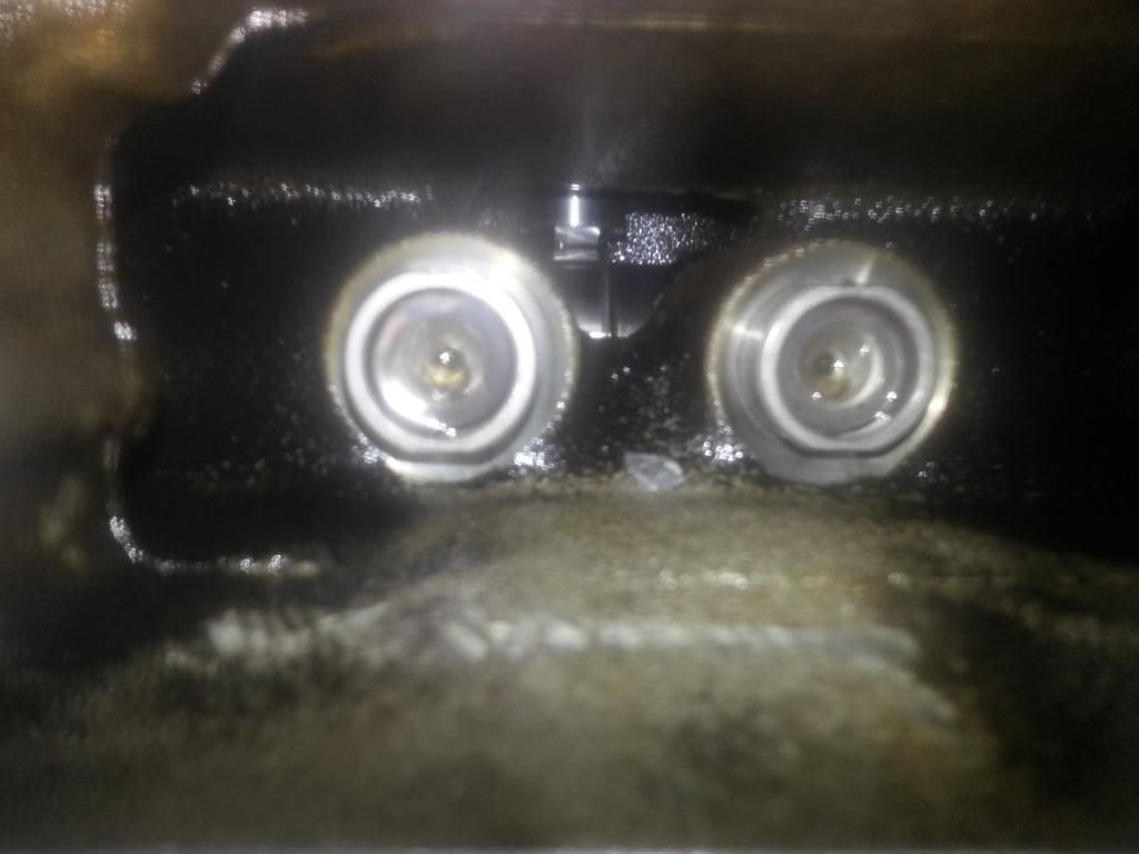

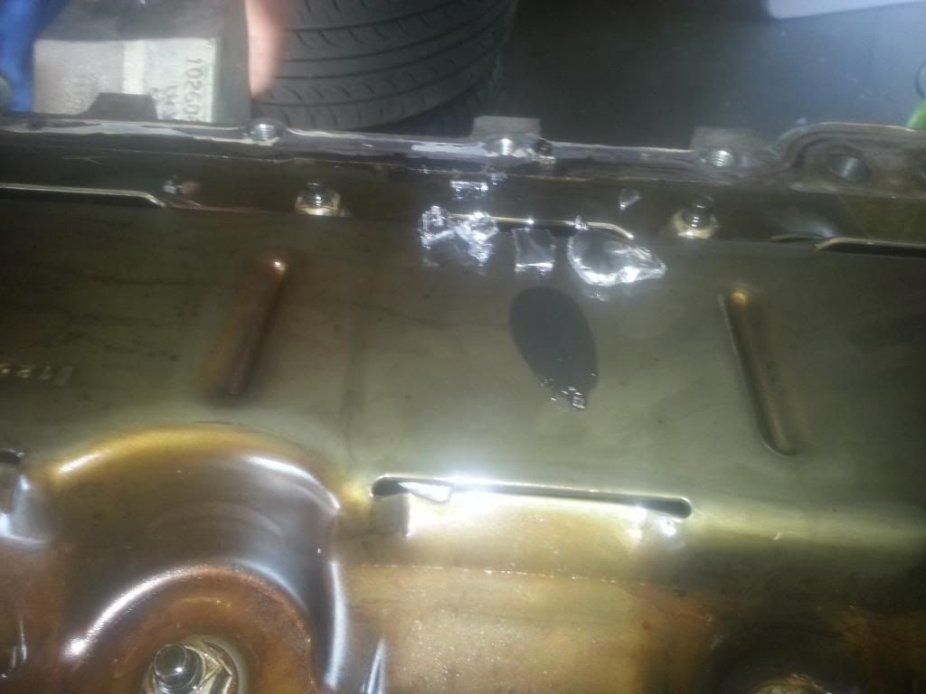

when i got the motor pulled down to this point, i was kinda hopeful, no signs of damage so far, then when i took the other head off, i knew something was broke.
http://i741.photobucket.com/albums/x...ps3bf980bf.jpg
the other side, my first clue something was stuffed
http://i741.photobucket.com/albums/x...ps6678bc6b.jpg
it actually looks like 2 broken pistons, front and rear on drivers side, and four bents rods, both front and both rear cylinders. a small scratch in a bore and some marks around the rotating assembly at the bottom of the cylinders, on the crank etc..
