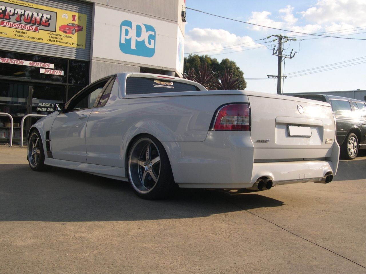

They didn't explicitly mention the need for shocks - and I didn't ask either as I was in a rush - but I know from experience that you are going to need short stroke shocks if you lower it too much. In my old VY SS ute the front would bottom out if it hit say a storm water cover or similar bump in the road at speed.

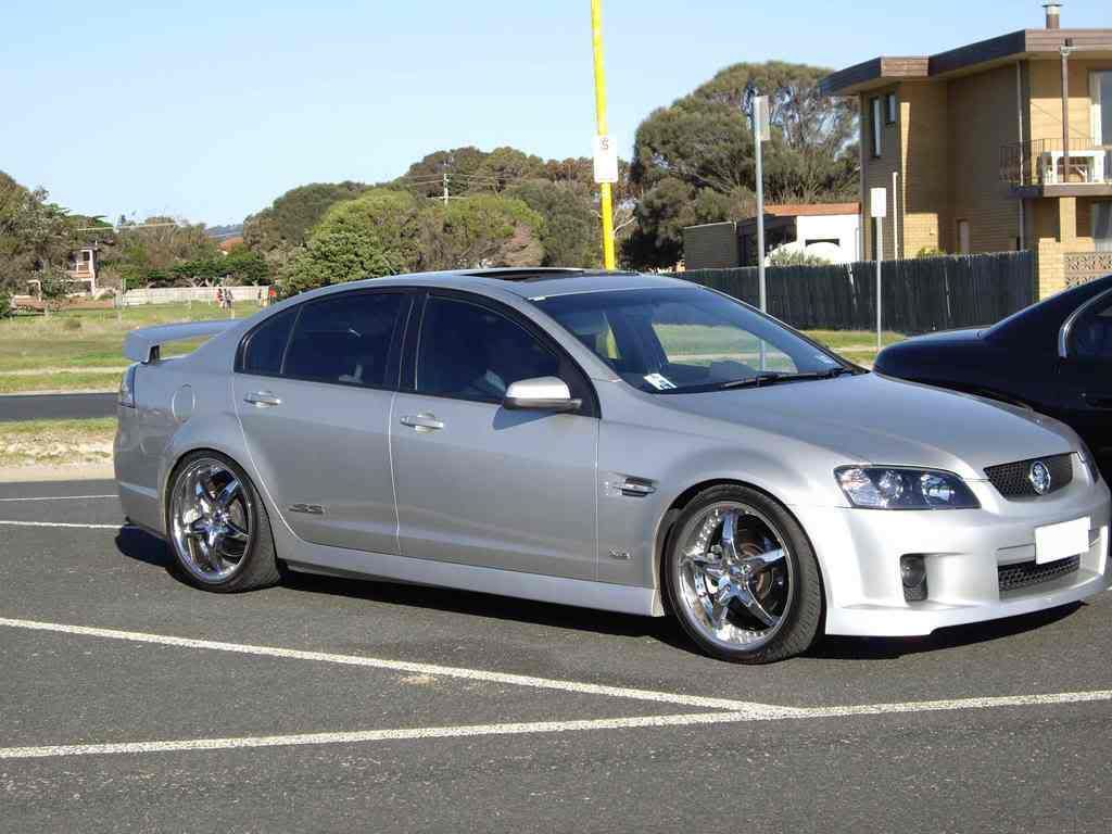

IMO they're half right - if they meant only 25 - 30 mm with stock shocks they're right, but not everybody can afford coilovers which are a substantial jump in price over springs and shocks - new King springs with Monroe GT short shocks are just under $700 on eBay (assuming VE stuff suits VF) plus allow around $300 for fitting and 4 wheel alignment. Most coilovers are double that and more, typically not including fitting. That's a big premium to pay if you're mainly interested in looks with better handling but not optimum handling.
Plenty of us on here have run Kings and Monroes down to almost 70mm lower without sacrificing comfort, although some guys who push their cars harder feel the King/Monroe combination is a bit soft in the rear when pushed so have gone to HD King springs with the Monroes - apparently pretty good! Other more expensive options include Koni yellows which everybody seems pretty pleased with.
My old SSV sedan on Kings & Monroes then my ute - seemed fine to me!!
http://i122.photobucket.com/albums/o...ruiseSep08.jpg
http://i122.photobucket.com/albums/o...pr062011sm.jpg
