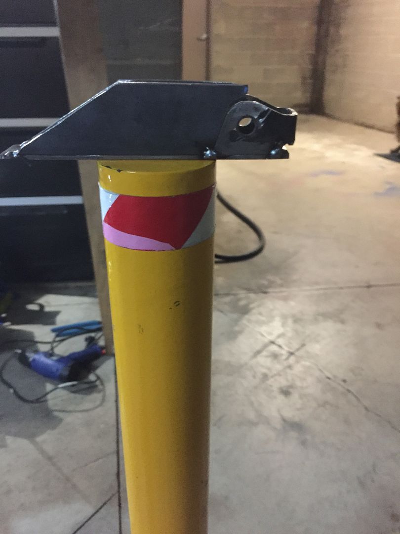

A few days ago I had the engine in position as far back as I could go and marked the sump to clear the steering damper. I couldn't cut anymore because of the oil pickup and was cheering because transfer case was in same position. No need to modify drive shafts, right? All seemed good, until I put the engine mounts in and needed to go further back. Couldn't cut the sump more so made s drop bracket for the damper and realized I didn't need to cut the sump at all. Lots of swearing followed.
http://i44.photobucket.com/albums/f4...psddstbwem.jpg
This is prior to final shaping and welding up.

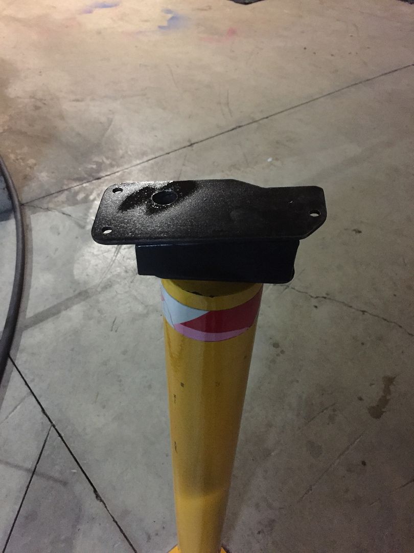

Here is the accelerator pedal mount
http://i44.photobucket.com/albums/f4...pswytytqko.jpg

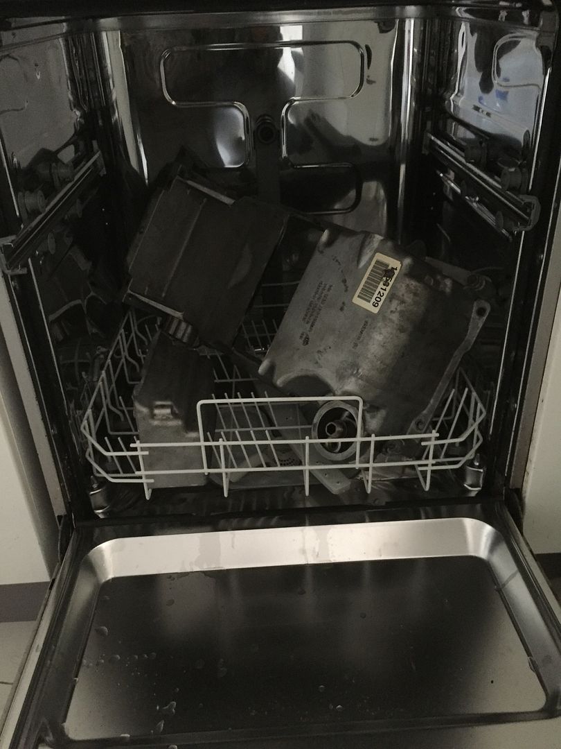

Do you think she will mind?http://i44.photobucket.com/albums/f4...ps8rilkz0s.jpg
I hope that's your one out in the shed, my missus would $hit eggrolls !!!
In fairness I did run it past her first.
She was very hesitant and asked what it was...
Oh it's just a crank cover. Just to keep out the dust
I made sure it did a 2 tablet pot wash when she was out haha
