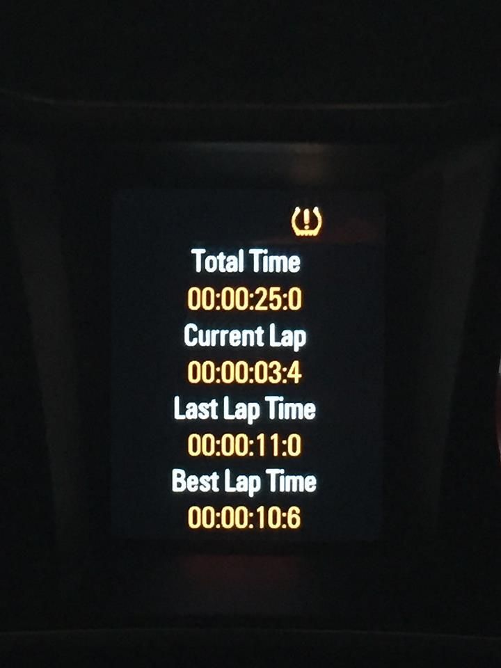

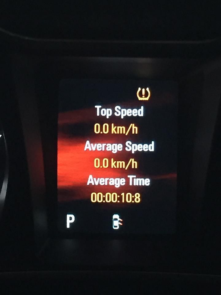

Do mean like I enabled on this VF S1 cluster (can do it on a non color VF one too just doesnt look as flash lol):
http://i601.photobucket.com/albums/t...pswya3gg3b.jpg
http://i601.photobucket.com/albums/t...psm12kbu3b.jpg
http://i601.photobucket.com/albums/t...ps4azcavlh.jpg
http://i601.photobucket.com/albums/t...ps1mpjaxqg.jpg

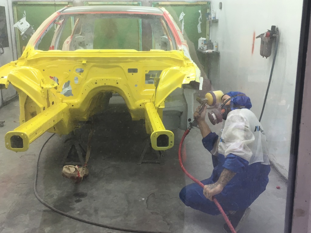

White Base Coat to even out the colour... Therre are two black doors and a black bonnet to cover compared to the rest which is Prussian Steel
http://www.rescueit.com.au/images/fo...401216_iOS.jpg
And the yellow begins.
http://www.rescueit.com.au/images/fo...342819_iOS.jpg
http://www.rescueit.com.au/images/fo...939661_iOS.jpg
http://www.rescueit.com.au/images/fo...9753_iOS_1.jpg
http://www.rescueit.com.au/images/fo...918745_iOS.jpg

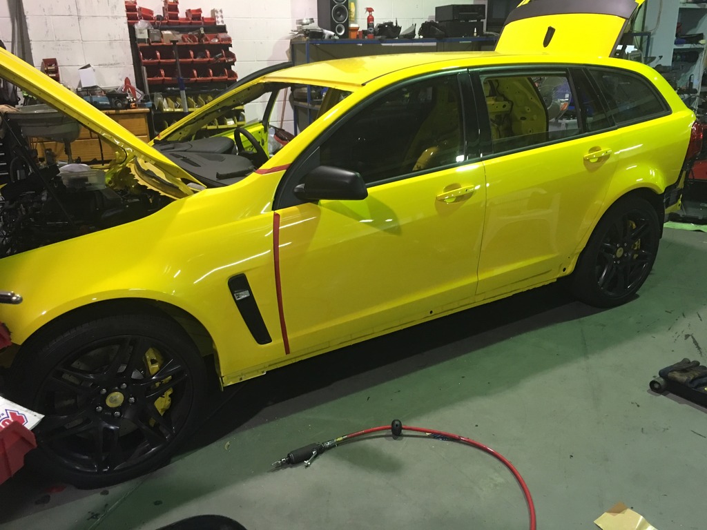

So the car is back from paint ! :bravo::bravo::bravo::bravo::bravo::bravo::bravo:
I have hung the doors and the liftgate.
Door handles, catches and strikers are all in and aligned.
Next for the dynamat and then flll the doors with windows and wiring....
I'm hoping to have it finished by my birthday in 4 weeks. Best present ever.

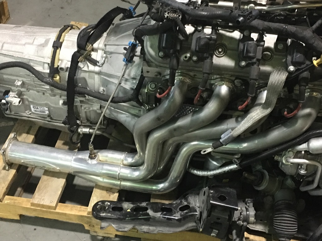

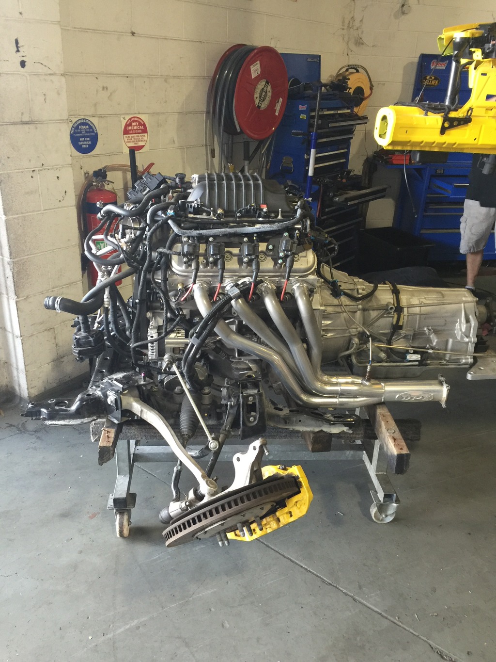

I got myself a little early birthday present for myself. DiFillipo 1 7/8 headers and full zorst.....It was at the right price. The headers required a little fettling ( As ED would say) to get them to clear the ground and the dipstick... Die grinder to the rescue.
I will tune it and drive it for a while then do the pulley upgrade..... I'm going to keep the bimodal just for authenticity. Will cut the tips off the zorst and have the bimodal tips put on....

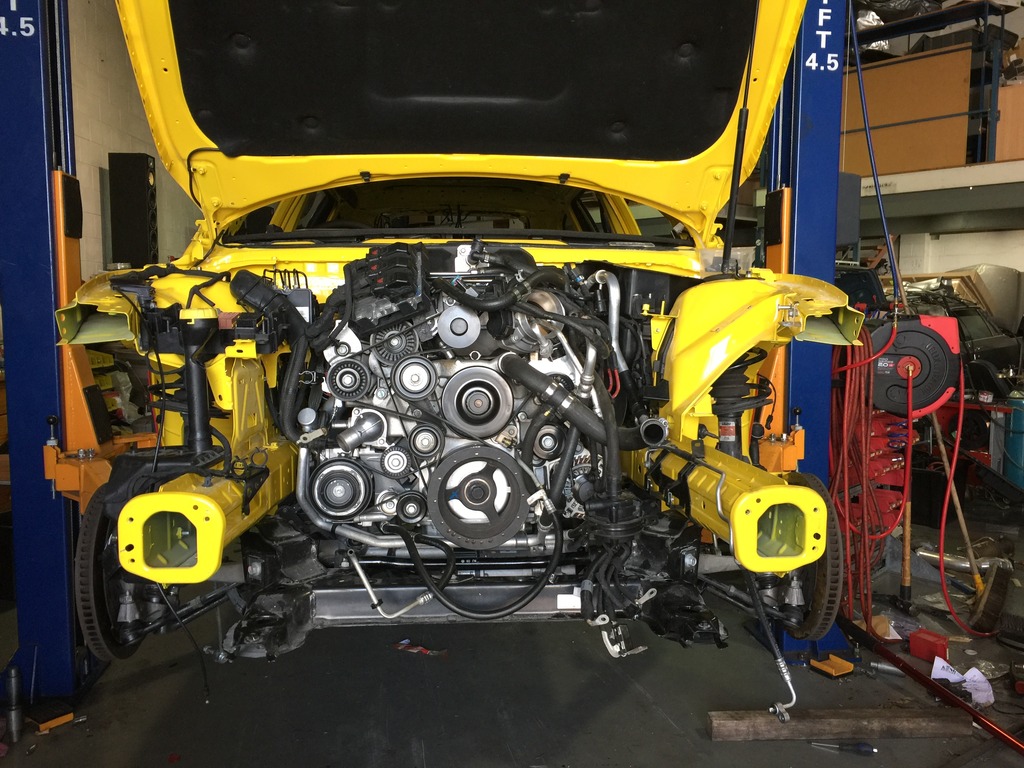

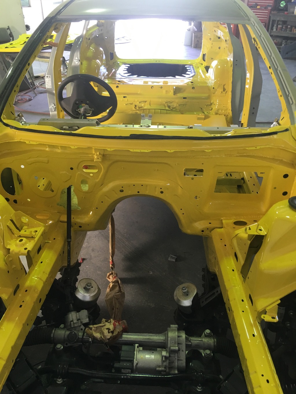

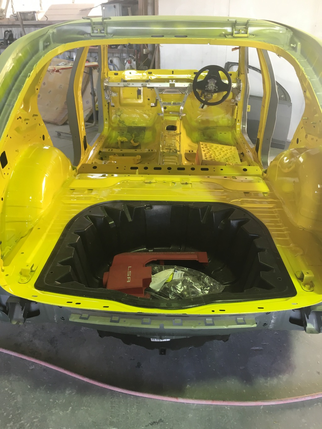

I had to cut the rear spare wheel tub out a little to make the massive diff and k-frame fit. Will require some fabriacation to fill the hole... Nothing major. Actually far less than I thought I would have to remove.
I will fab up the section to allow the compressor that comes with the GTS to fit in the spare wheel well in the factory pocket that we saved from the gts shell along with my stereo stuff .... Think the bose will be binned before its ever installed.
http://www.rescueit.com.au/images/fo...014350_iOS.jpg

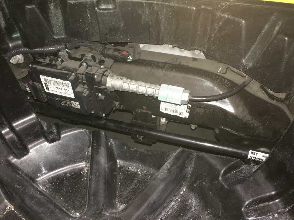

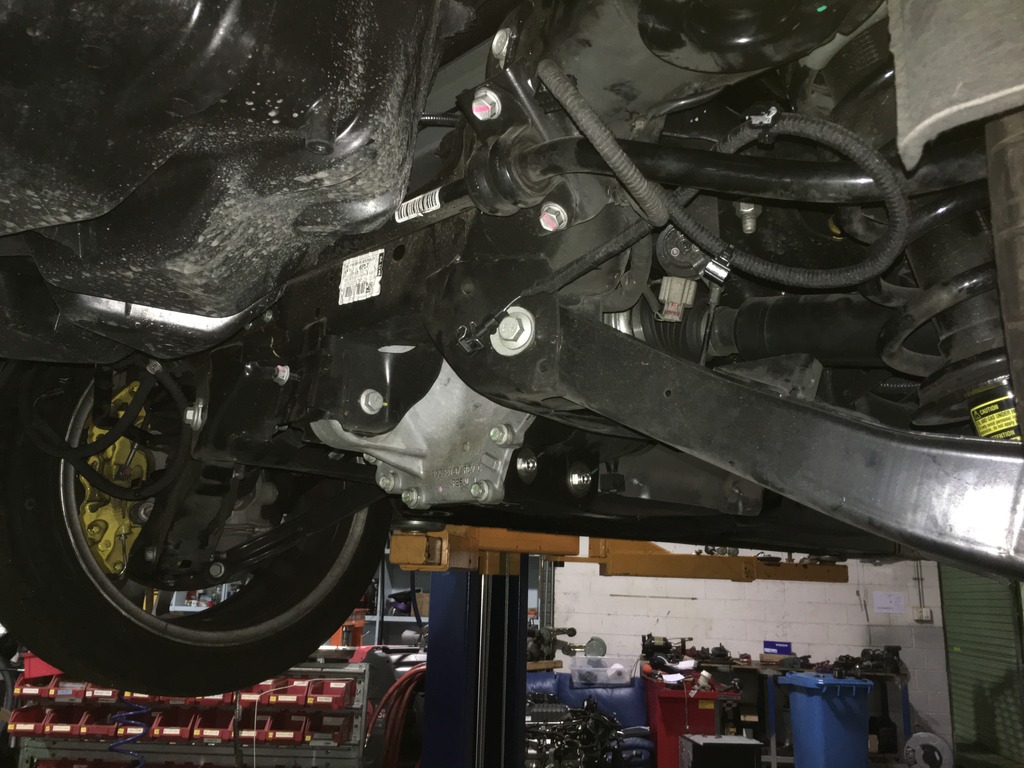

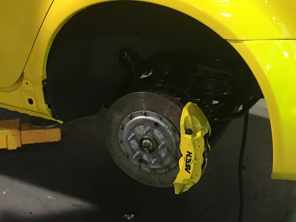

Looking through the rear window at the electric park brake and that ample sway bar. IT's three time the one on the other car easily. SS is same as evoke and freaking tiny compared.
http://www.rescueit.com.au/images/fo...831571_iOS.jpg
MMM Brakes...! MRC in and wired. The wiring hanging down is for the bi modal solenoinds.
http://www.rescueit.com.au/images/fo...050682_iOS.jpg

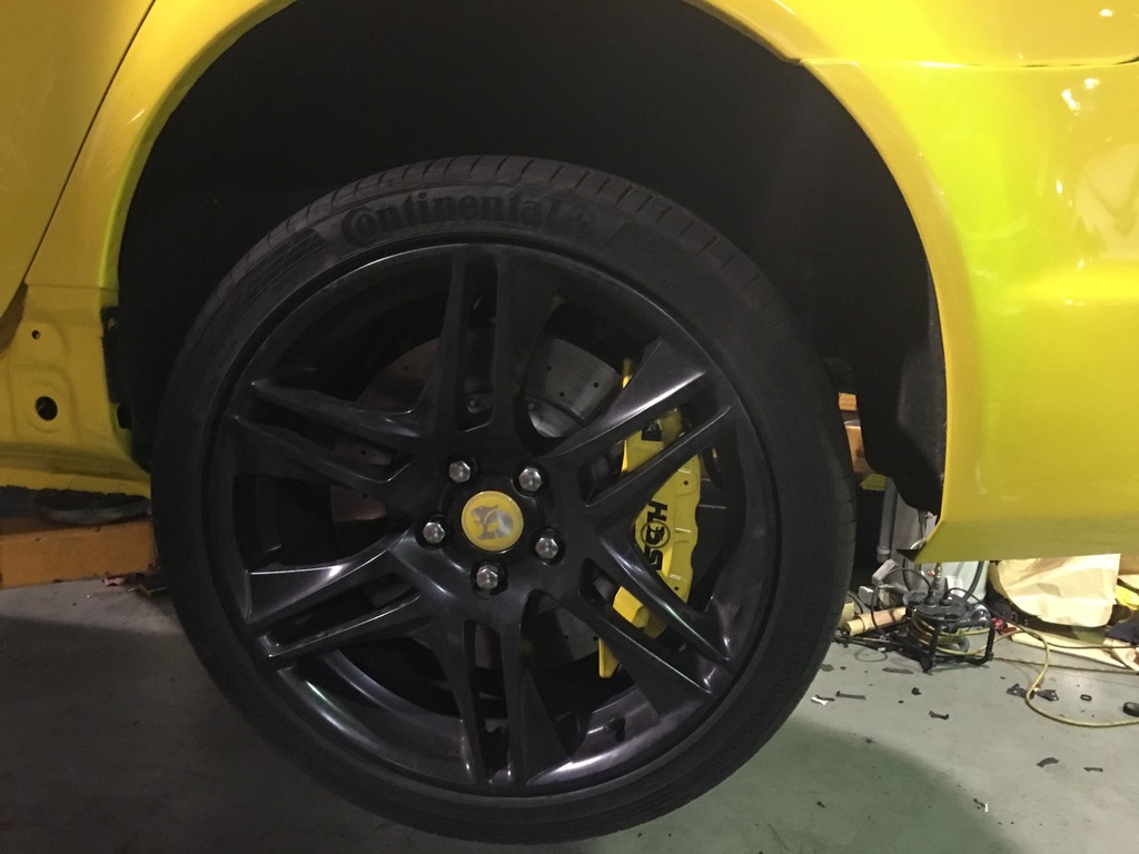

Wheels - Totally Perfect
http://www.rescueit.com.au/images/fo...137624_iOS.jpg

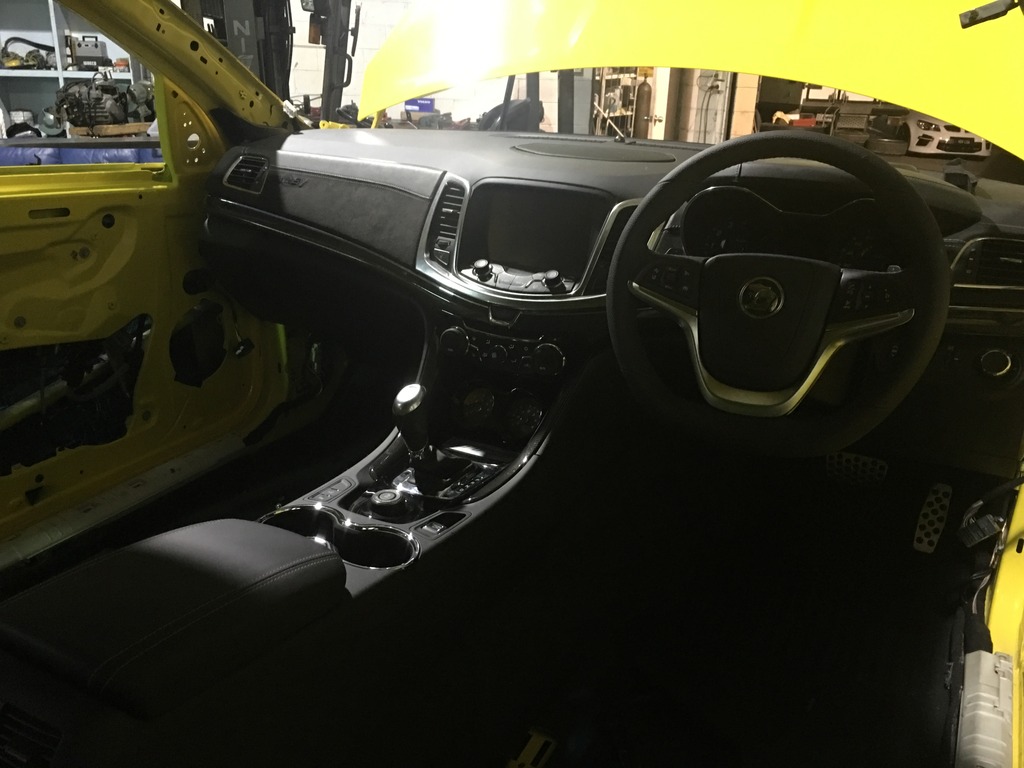

Dash and centre console is in. Resisted the urge to put the seats in as no electricity and makes it hard to install so I'll have to wait. DOH!

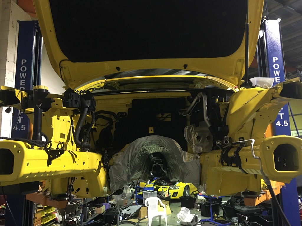

Hole prepped, wired and ready for the massive donk. HSV adds some nutserts to attach brackets for the intercooler pump and piping so that had to be done.... but there is a bolt hole there already to locate so twas easy.
Waiting for some insulators from holden before I can put master cyl and brake booster in but that can happen after the engine goes in.

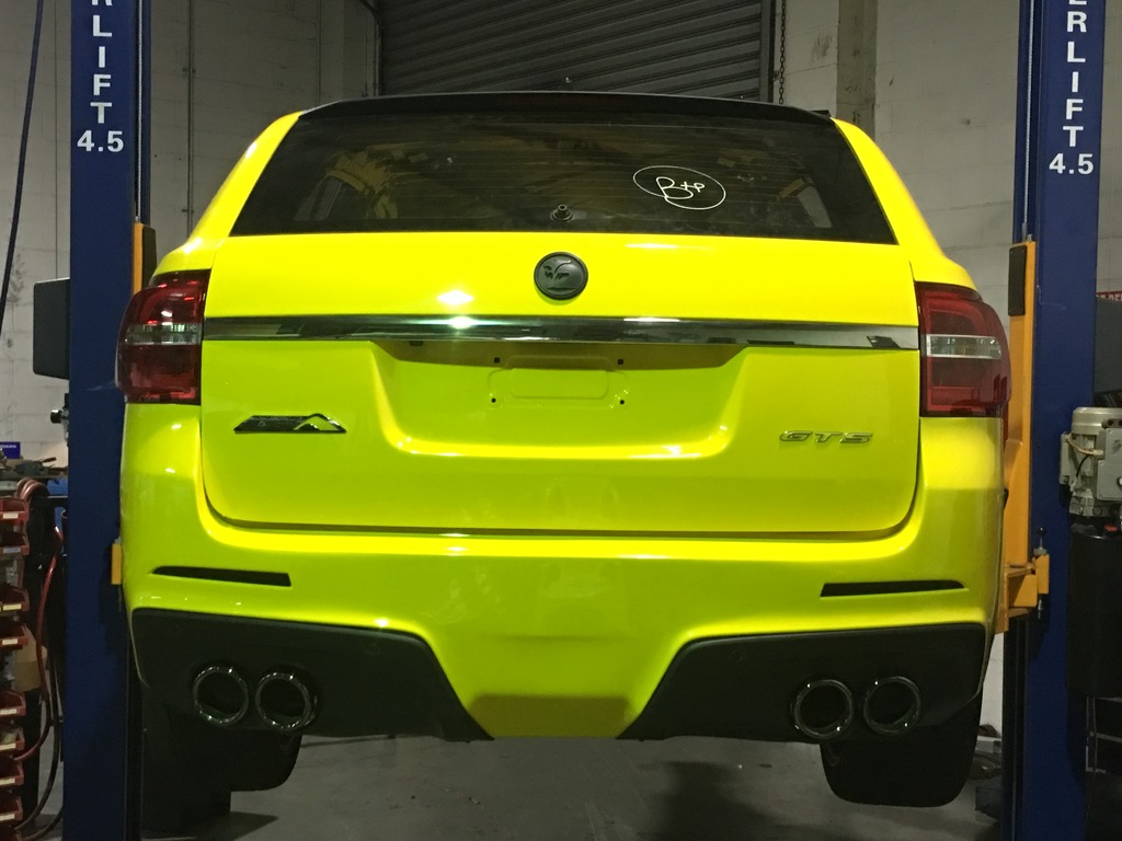

So.... I debated whether to post this up as it is sort of the main visual differentiator that this car will have from a Tourer and is totally custom and make it an actual GTS but what the hell.. HSV Should have done this.
And its no real secret I'm doing this......
Quite proud of this though. Not that I actually did it but project manager, ideas man and all..... Credit Taken.
So without further adue .........drumroll emoji would be nice.
http://www.rescueit.com.au/images/fo...148909_iOS.jpg
I will make the chrome strip satin black with some plastidip or wrap as I'm not paying $400+ for the black one.. Also really thinking of making the roof satin black. Number plate will make a difference also as they are QLD prestige plates that are black and silver.
The electrics are not operational so the lift gate is not totally shut and I haven aligned it yet but I couldn't wait. I'm not sure about the lsa and gts badges.. think the yellow needs to be black. A syringe with sme black paint should solve that.
I'm spending most of easter in the shed so tomorrow with some help from a mate I'll get the engine and the rest of the running gear in and she can sit on her own four feet for the first time. Maybe even the radiator support as well...

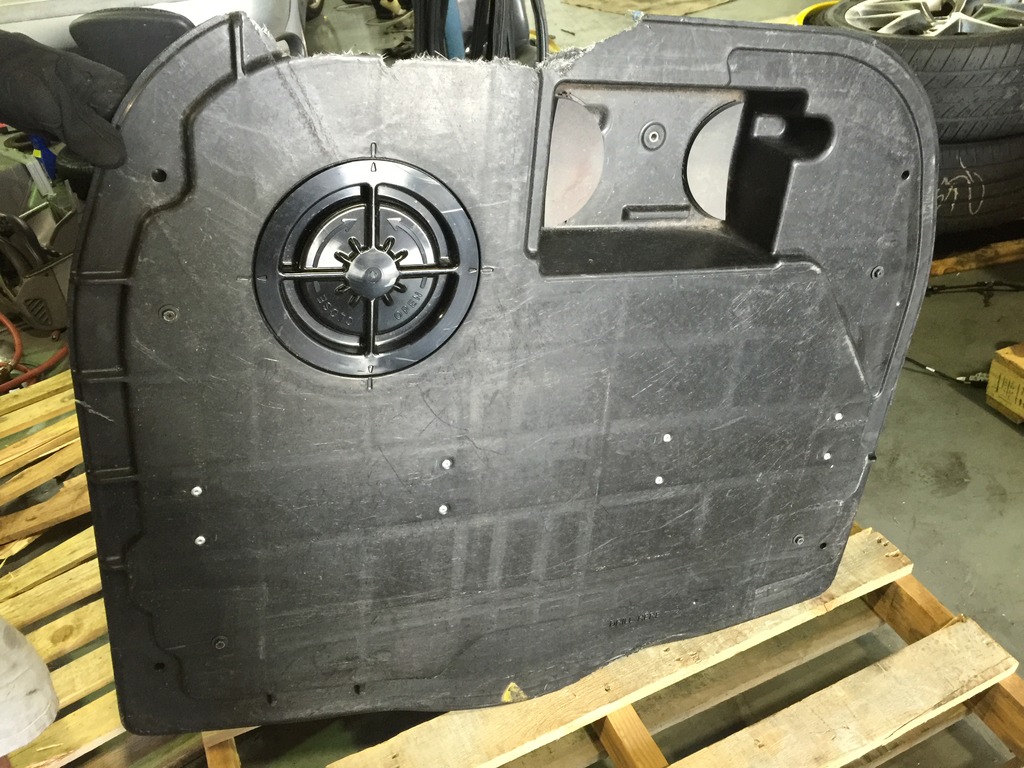

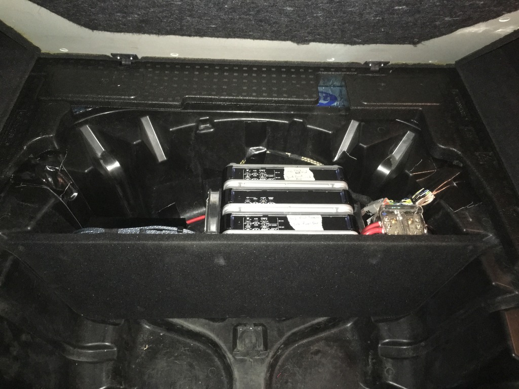

Im using the spare wheel tub with the front cut off of it as it is glued to my floor. I will cut the compressor piece out of the salvaged floor and fibreglass it into position to cover the hole I cut up and leave room for my amps...
Like this but the amps will be behind the partition and the compressor will be at the front on the top.
http://www.rescueit.com.au/images/fo...517104_iOS.jpg

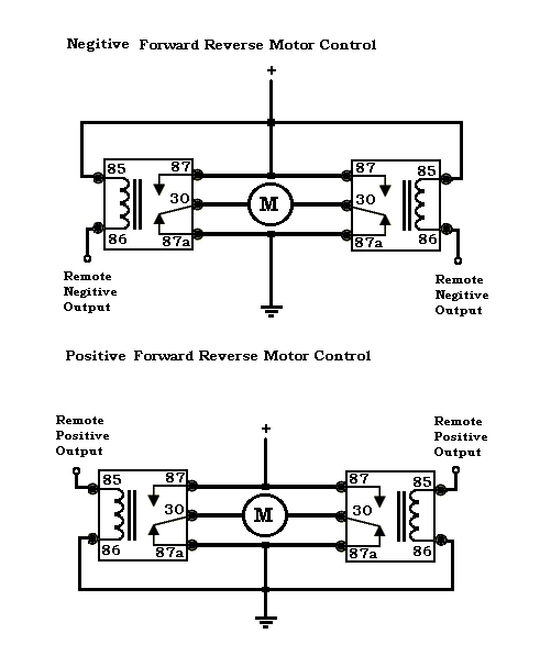

I have to wire the rear washer differently as the standard Vf uses twin motors for front and back. The GTS relocates the washer bottle to move it away from the intercooler. It cannot have twin motors so I need to use a reversing polarity one that has two outlets that direct the flow based on which wat the motor spins. This is how it has been done in most cars I have seen and the twin motor thing is unusual.
I will make a circuit up like this to drive the motor from two positive signals like the lower diagram.
http://www.rescueit.com.au/images/fo...or_control.gif
Engine is in and all the driveline is connected. It tokk 10 minuted to put the engine in thanks to some help from my daughter operating the hoist.
It almost fell in.
