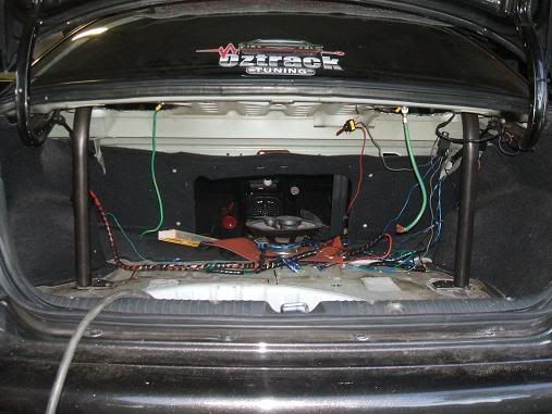

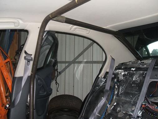

just went with this as its still a 60 kay daily driven car as you know to drop 8/10ths is huge retain that sleepa look with no cage etc if ever hit 9s will make the decision of what to do then then theres always this$$$$$!!! cheers
Your aloud one bend i have the template if you want it...
http://i273.photobucket.com/albums/j...srollcage2.jpg
http://i273.photobucket.com/albums/j...srollcage1.jpg
yeh cheers mate ive seen that in sedans like yours down thru speaker holes with one bend !!!all is good cheers !!!
No worries stiffens the launch up a heap too, i have been doing 138mph passes on one hand makes a huge difference picking up the rear point of the rails..car goes dead straight any way all the best with it cant wait to see the results you get..

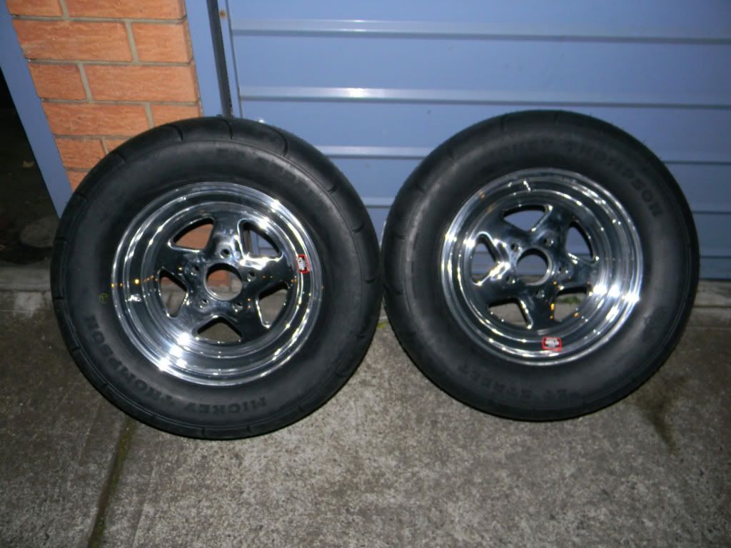

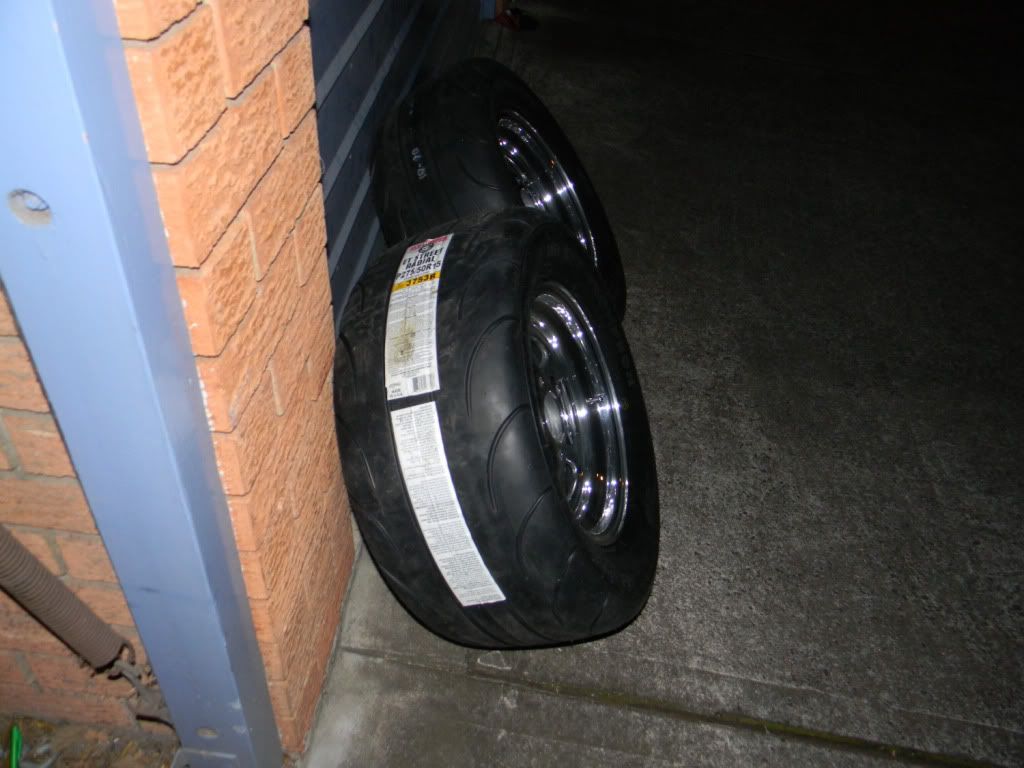

hi bought these a few weeks back hopefully help with launch 1.774 60ft with 275 /40/17 due to big brakes change to stock ones fit these weld pro stars 15x8 5.5inch backspace with 275/50/15s hopefully a tenth or two here ???cheers
http://i942.photobucket.com/albums/a...s/DSCN0045.jpg
http://i942.photobucket.com/albums/a...s/DSCN0046.jpg

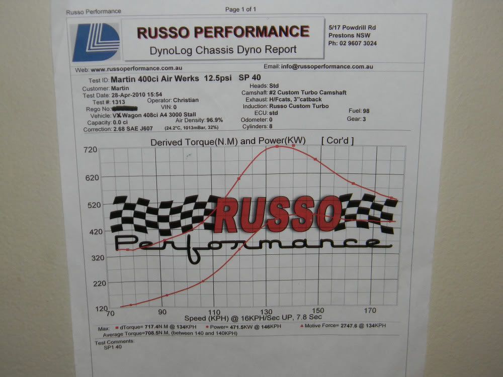

heres a dyno sheet !!!!!
http://i942.photobucket.com/albums/a...SCN0018_02.jpg

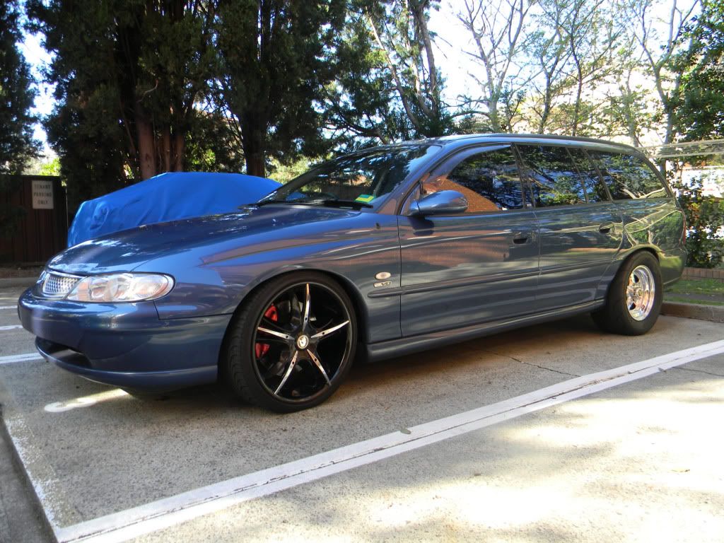

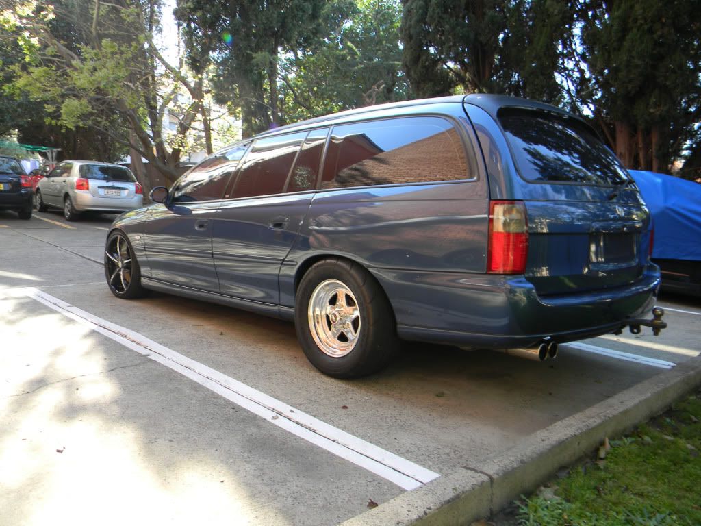

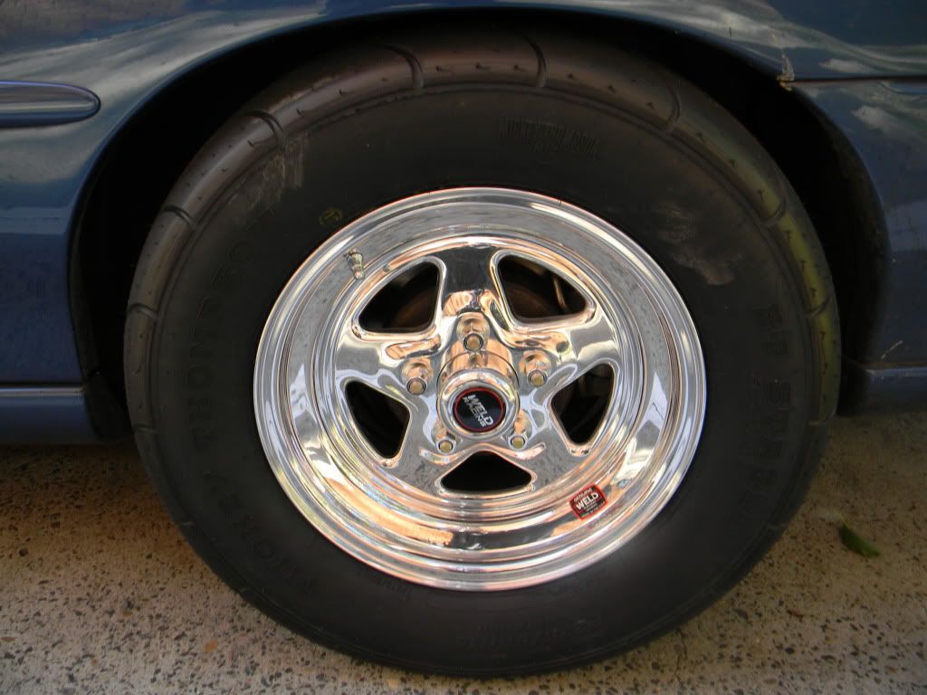

hi just an update had arp long wheel studs and standard brakes fitted had andra tech inspection done this afternoon passed with only a few minor things need collars on taxi bar of cage to prevent harness sliding sideways and need to seal/vent battery he checked everything on hoist etc so just need to complete paperwork and im back on track havnt run since may aiming for wed 22nd will be interesting what better tyre combo and another boost setting will do cheers:)
heres some shots with the prostars on the back full strip trim got some wtf looks fighting traffic for 1 and 1/4 hrs after tech inspection yesterday cheers!
