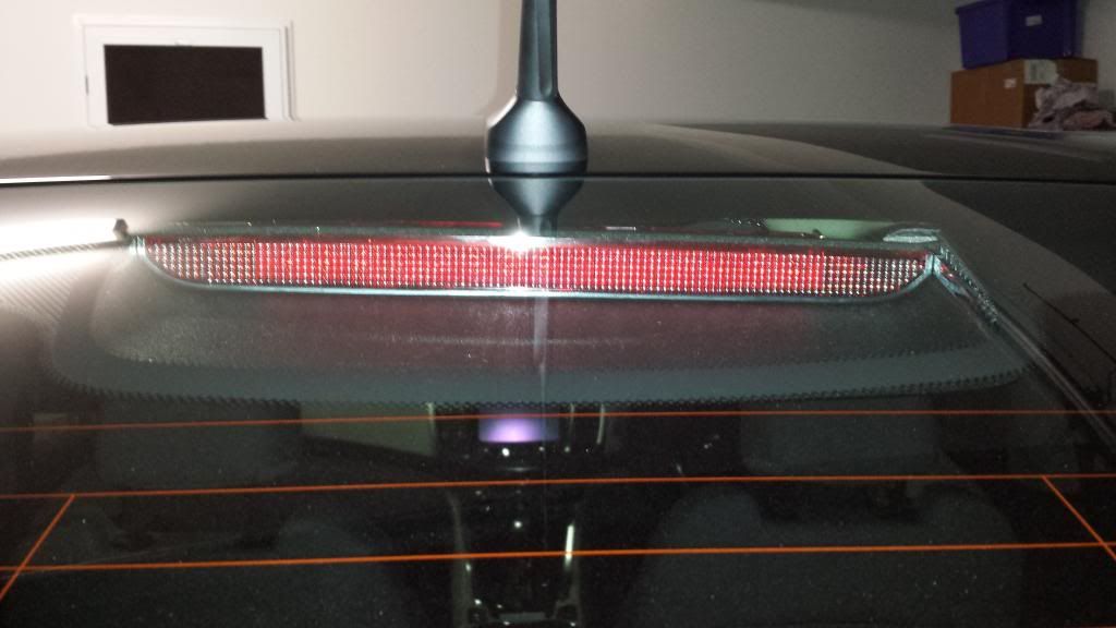

I have two issues popped up...
1. The brake light strip at the top of the rear window has dropped down on the RHS so the strip is on an angle. Looks like the adhesive used to hold the strip up has let go,

Re: VF Commodore/HSV Owner's Problems & Complaints
jkgmh
2. When I corner and the body momentum moves in the seat something under the leather is moving under my ass...it is a bit offputting when cornering.
First service oops I mean first inspection list started...
Crusty
I too have noticed the corner thing with the seat, and yes it is off putting as I can't make it do it unless I go around the corner. It's like there is something inside the seat rolling about.
Glad to see I am not the only one with the seat issue...can you guys check the brake light on the rear window...

When I started my car this morning a "service front camera" warning came up. I had no front collision warning or lane change warning working. When the engine was turned off and restarted the fault had cleared itself. Let's see how it goes on next start up.
jkgmh
I'd say it should log a fault code that Holden could check. Mine is going in for its 3000k inspection today and I'm asking them to check the HVAC software. My brake light isn't perfectly level but isn't falling away like yours but will ask them to double check it. Not sure wether to bother about the seat thing.
