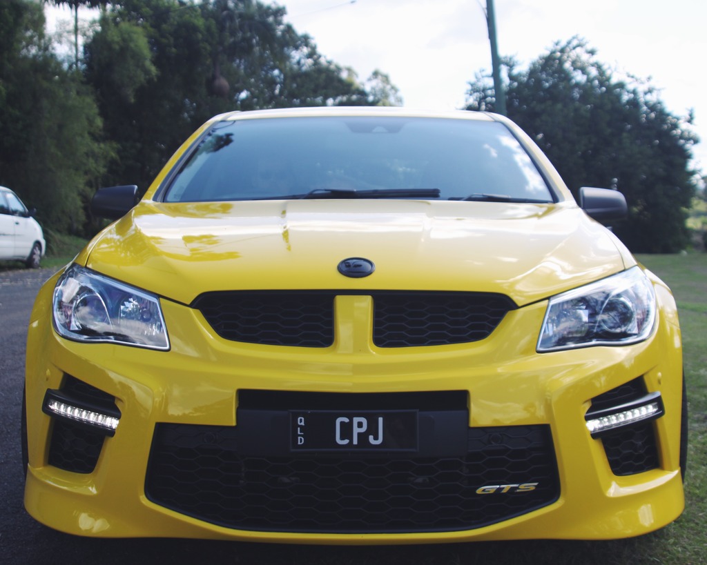

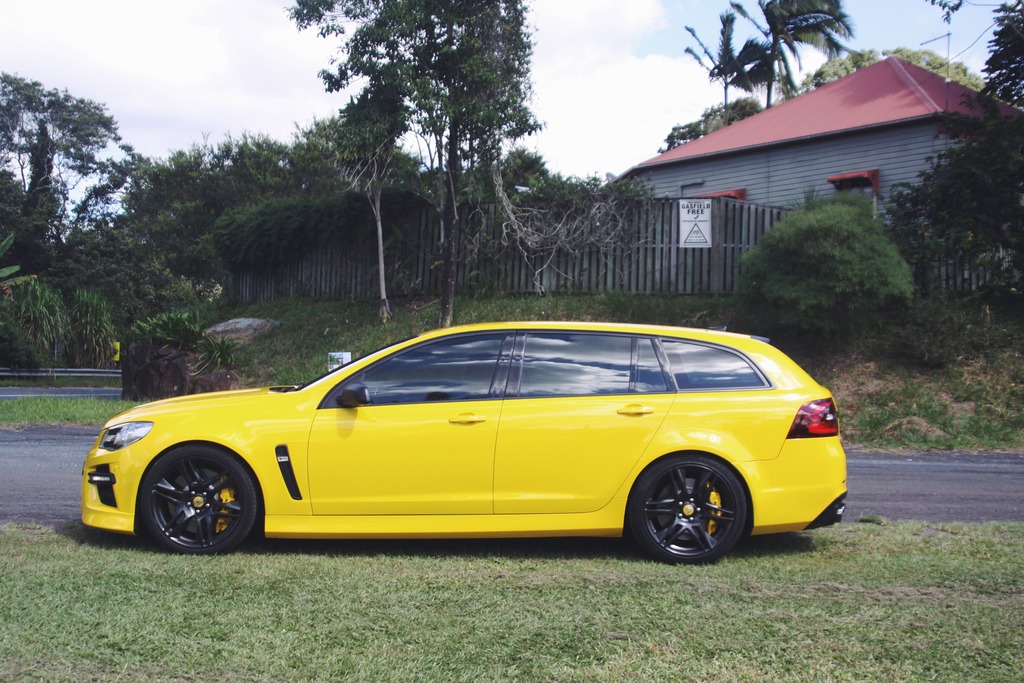

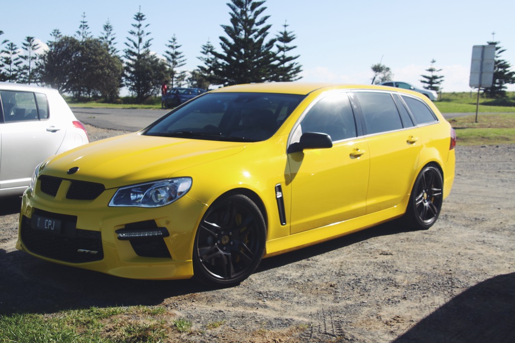

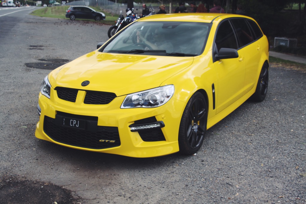

Went on road trip to Byron Bay today and took a few photos.
http://www.rescueit.com.au/images/fo...827420_iOS.jpg
http://www.rescueit.com.au/images/fo...719920_iOS.jpg
http://www.rescueit.com.au/images/fo...713130_iOS.jpg
http://www.rescueit.com.au/images/fo...820270_iOS.jpg
http://www.rescueit.com.au/images/fo...718900_iOS.jpg
http://www.rescueit.com.au/images/fo...700050_iOS.jpg
