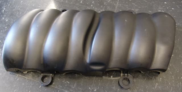

For a cooler inlet manifold remove the nvh cover off of it, you barely even know its there till you look closer, take it off! And no im not talking about the bloody engine cover!
Re: VE heater hose relocation
Is it really worth the effort with moving the hoses? It dont look bad at all if u have a dremel and take ya time to trim them up nicely.. only my opinion tho
SV346

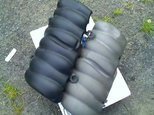

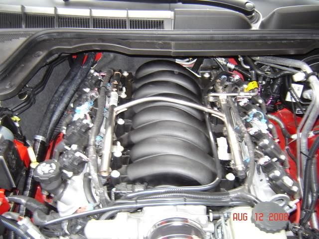

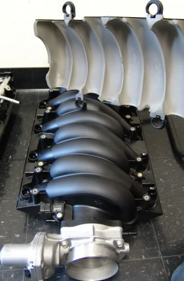

It's only the newer LS3 intakes (that also fit L76/L98) with the bolt down MAP sensor at the front that have the removable Beauty/Noise Cover. You have to unbolt and lift the fuel rail to get it out.
http://i2.photobucket.com/albums/y20...seperate-1.jpg
http://i2.photobucket.com/albums/y20...nderside-1.jpg
http://i2.photobucket.com/albums/y20...706081817a.jpg

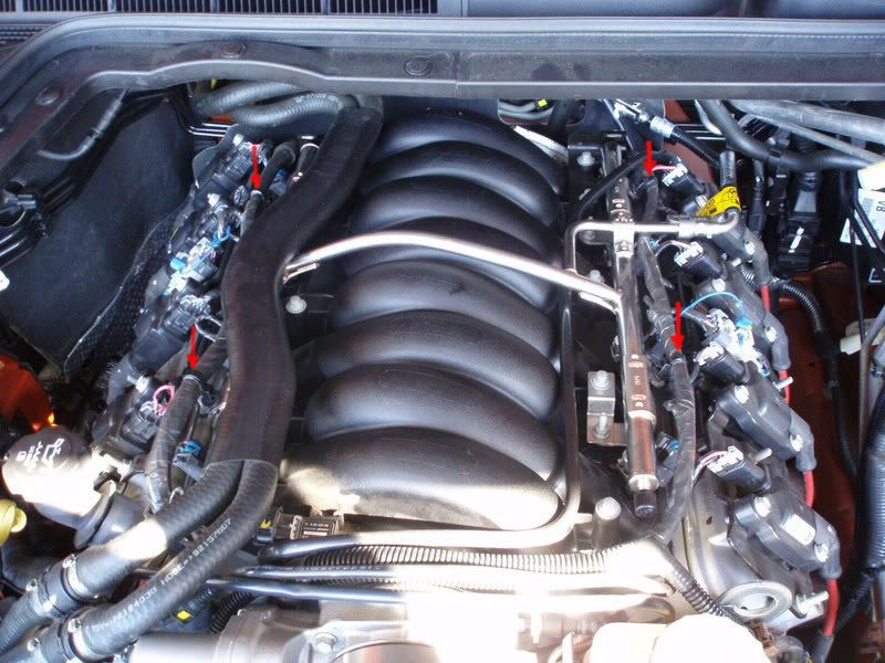

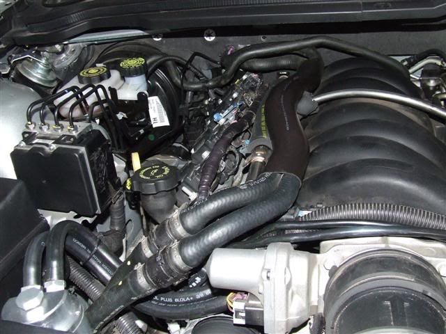

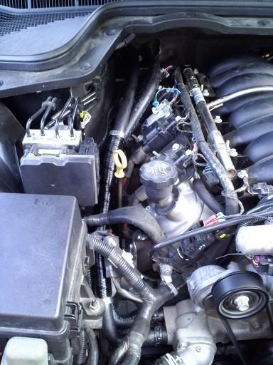

[QUOTE=VX-300;1477746]Heaps of guys in the USA have done this on the Pontiac G8-GT.
(Rebadged LHD VE SS).
New Relocated Hose Pair (front of pic)
http://i2.photobucket.com/albums/y20...s/DSC03818.jpg
Are the bottom hoses off a particular model or are they a custom set up?
They're aftermarket made up hoses.

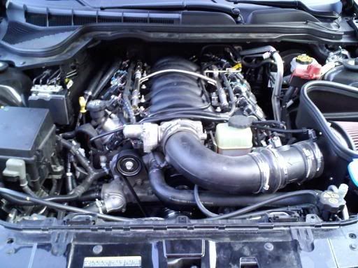

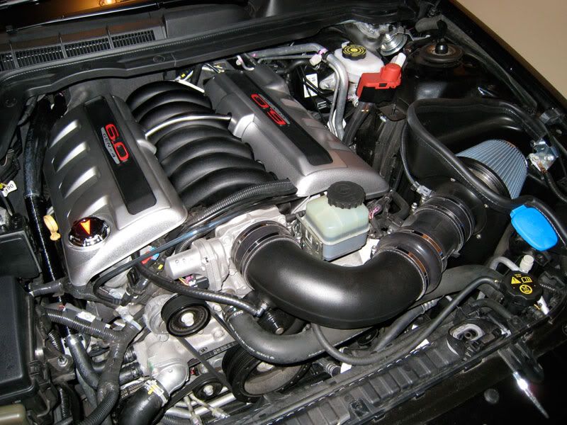

Tony, I know it a bit late but heres a pic of a VZ 6ltr engine bay, you can see the heater hoses run up the drivers side rail.
Dont know how well they would match up to the heater on a VE though ....

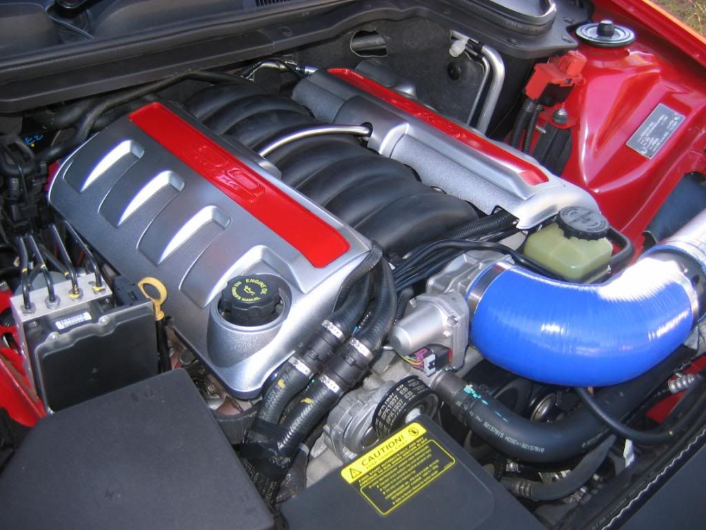

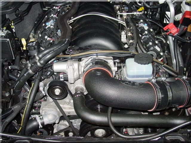

That's a good looking CAI, what brand/model is it?
Marco
DUSspeed.
Damn you know how to put together a tidy machine Gary! :bravo:
Yep, as Dave said, it's a DUSspeed made by forum member Dus. I had mine painted to match the body colour.
Seems to work very well too!! Had the ute tuned yesterday by Chev. My sedan was (AFAIK) the highest powered bolt-on A6 L98 at Chev's with 264rwkw (261 on his new dyno), so given the ute hasn't even done 2,000km yet (the sedan definitely got much stronger after 10,000+km) and is a 260kw AFM L76 I was going to be happy with anything over 250rwkw.
260.3rwkw with Dus OTR and mafless tune. :woohoo:

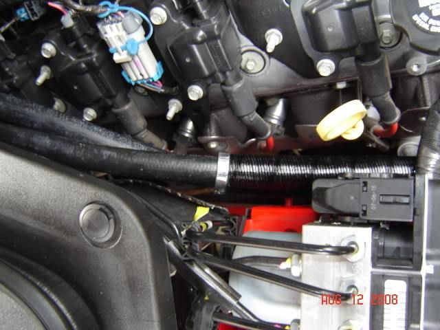

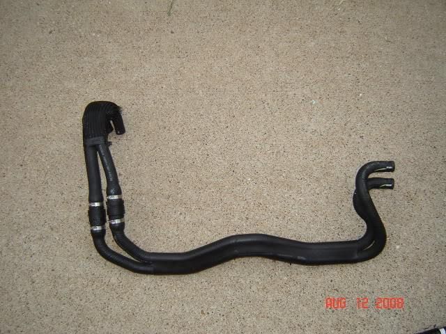

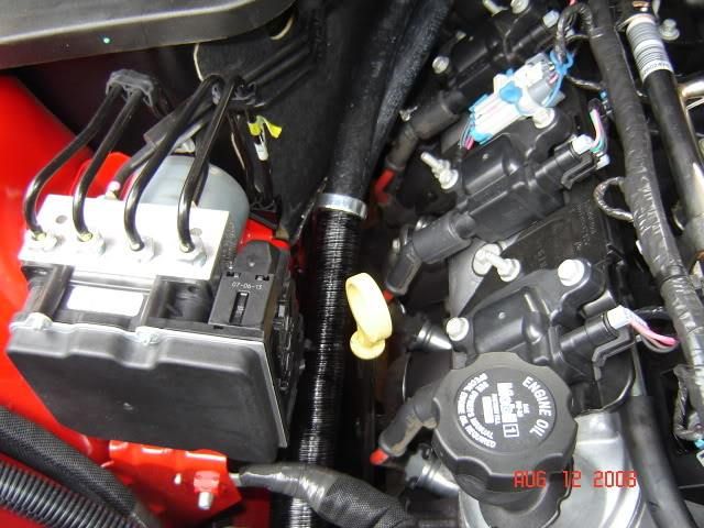

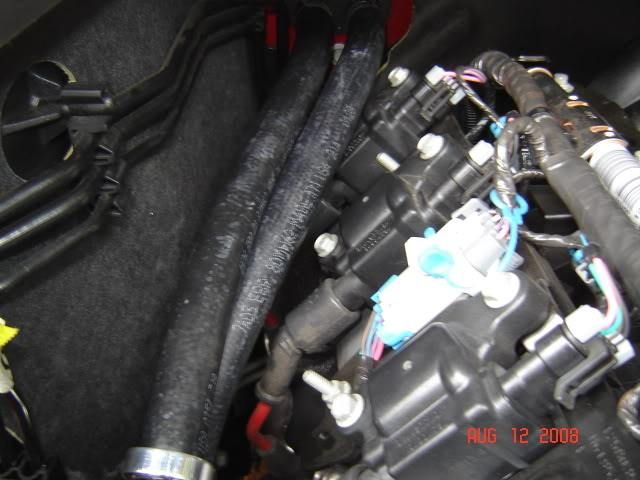

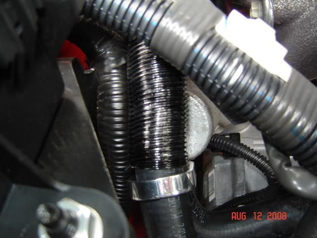

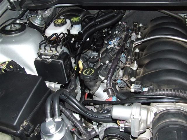

Tony, finally had my OTR fitted and tune today at Chev's and Big Rob also did his heater hose re-route for me.
Thanks for that. It has helped me heaps. Nice numbers you got as well.

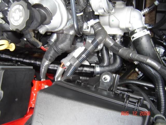

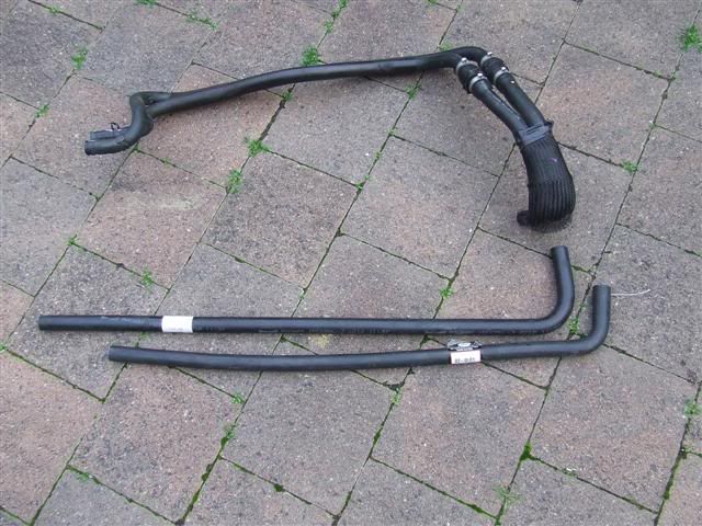

After a bit of research, I have found that the heater hoses to use to relocate the VE hoses are actually made by Holden .... you simply use the long heater hose from the Commodore V8 models VC-VK as this gives you more options when routing the new hoses. The VC-VK models have two heater hoses ... use the long one and buy two of them. All up cost is $20. These hoses have the 90 degree bend to use at the water pump end. Although Holdens VB-VE all have two sizes of outlet at the pump end, Holden simply use the same size hose as there is plenty of stretch in the hose to fit over the larger nipple. Different suppliers may have a flared end but it really is not needed. I used some 25mm corrugated split tubing around the hoses to protect against the heat from the hoses and a couple of plastic ties.. another $6. All up $26 and you reuse the existing spring clips.
Note also that 6 cylinder blue/black motors VC-VK also have hoses that fit VE, but they are shorter than the V8 ones, hence go for the V8 ones to give better routing options.
It is best to get as much access to the front area as possible by unclipping two wire looms. The radiator is drained by undoing a screw under the radiator, kick the motor over for a few seconds to avoid a mess before the existing hoses are pulled off. A clean 10 litre bucket under the drain hole is easily big enough and reuse the coolant later. The end result is factory looking with no messy extra clips or joiners needed. It took 1 hour to do it ... next one would be half that!!
Sorry for what may sound like a dumb question but if I remove these hoses to have a 'fiddle' how much radiator fluid do I loose and do I need to plug up the connections on the water pump (to avoid the fluis draing out) whilst I am having a 'fiddle' :confused:
Tony, as Ron says, just use a bucket under the drain tap and pour it all back in again when done.
Hi Ron
Got any pics???
Ron SS

Hi Ron thanks for the pics looks good.

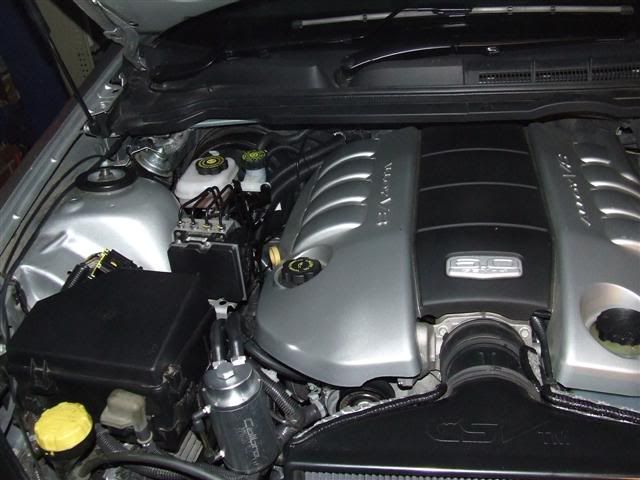

Tony,
I had a set of VZ L76 covers I bought 2 years ago for my Mar 07 build SSV sedan but never got around to putting on, so they were the ones I had painted and put on my MY9.5 SSV ute recently (as below). They still went on sort of OK but apparently the later models have an extra black cover over the intake (the black part in between the covers).
Big Rob at Chev's kindly removed that for me a week ago and now the covers fit much better. I haven't taken a picture since, so the picture below is with the extra black cover on still, but even then they did clip on OK and weren't going to fall right off. Note that even without the centre black cover the centre area still looks the same as under that there is still the black intake of the same shape (if that doesn't sound confusing and :weirdo:).
Gary
http://i122.photobucket.com/albums/o...ecovers1sm.jpg
PS The L76 covers are almost impossible to get at the moment as apparently the supplier is having some sort of problems. Due to a :doh: on my behalf I have a spare LH (passenger) side one (part 92068147) perfect and professionally painted white (identical to the one on my car). If anyone wants it I can sell it to them for $100 which is less than list price plus the $50 ea I paid to have them sprayed. You can have the one that's on my car or the spare - doesn't matter to me.

Was there much involved in removing the second intake valley cover that Chev's did for you. Congratulations on the look on this car by the way. Then again, you do have a track record of getting a VE to look the goods. One of your other posts had (the new wheels :goodjob:). What type/make/model and size of rim are they. Also, when they painted your covers did they fill them to make them smooth or just paint the existing texture. I take it the black insert is the original black plastic or has that been painted as well.
Cheers mate
Tony
Thanks Tony. :thumbsup: Unfortunately I was doing something else when Big Rob removed the extra intake valley cover but it didn't seem to take long and from memory he said about 15 min to do??? :confused: I'm sure he said the injector rails had to come off but apparently that's easy. My daughter went out and took another few pics for me earlier so I've included one below.
At first it doesn't look much different but then look at where the silver pipe across the intake now sits in the slot, plus how much better the oil filler cap sits now. If you look closely you can also see how much better the points of the cover sit in the grooves along the intake now that the extra cover has been removed.
To answer your questions in order: rims are DTM Shine, 20x9 front, 20x10 rear. When they painted the covers I assume they didn't fill but just sprayed straight over the textured part. However, unless you look really closely the textured section looks quite smooth. No painting on the black intake section in the middle - that's factory.
http://i122.photobucket.com/albums/o...verremoved.jpg
