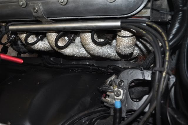

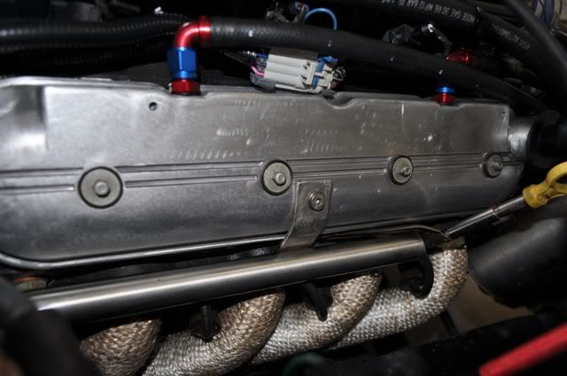

Here is a link to an interesting thread about the LS6 conversion and using the LS1 coolant lines.
Some people are converting the newer cars back to the LS1 coolant lines in the USA because they reckon it worked better than the LS6 system.
I recently did one and used a hammer and sharp wide blade screwdriver as suggested on here.
Worked a treat, no problems. :goodjob:
http://www.ls1tech.com/forums/genera...-manifold.html
(post 5 on...)
(post 35 on page 2 is a help as well.)

Thanks for that. I was going to use the hammer and screw driver method like you did. Those pics will really help/

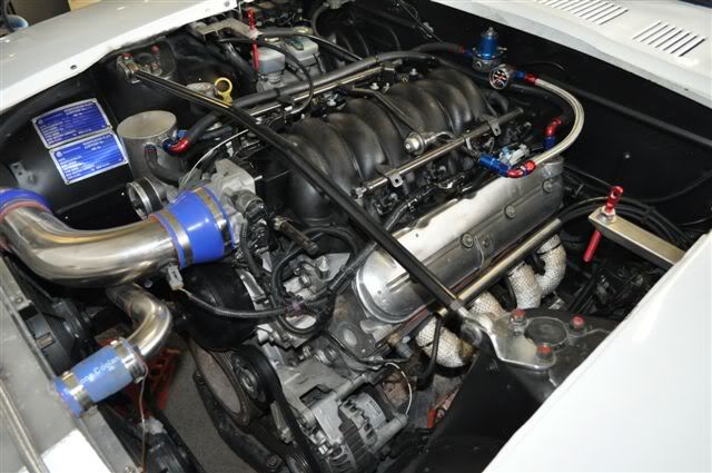

Well the LS6 manifold has been installed but after also installing the LS6 injectors, I was advised to wait until it gets a tune otherwise they'd run too rich, so the LS1 injectors went back in.
I think the seat-of-the-pants-o-meter has picked up some improvement in the top end just by changing the manifold.
I ported the entry to manifold as well as spare throttle body which required me to make up a new 78mm throttle blade as the factory size is 75mm. I haven't installed this bigger throttle body yet.

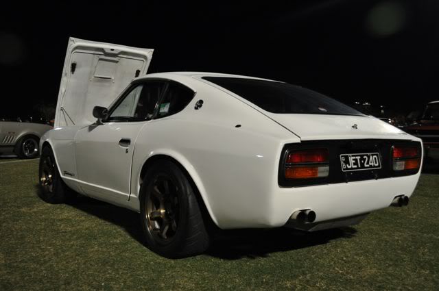

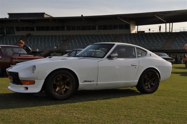

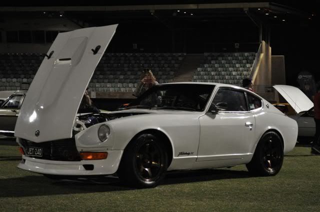

My Zed got to be in a car show as part of the Townsville 400. It was an awesome weekend. We got to do a lap as part of the drivers parade. Would you believe I only got one photo of it on the track.

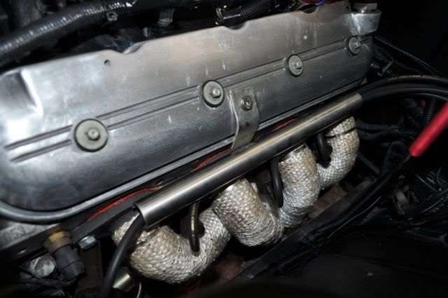

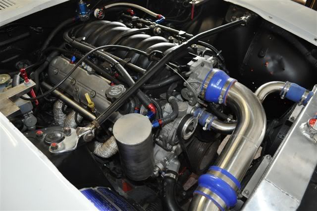

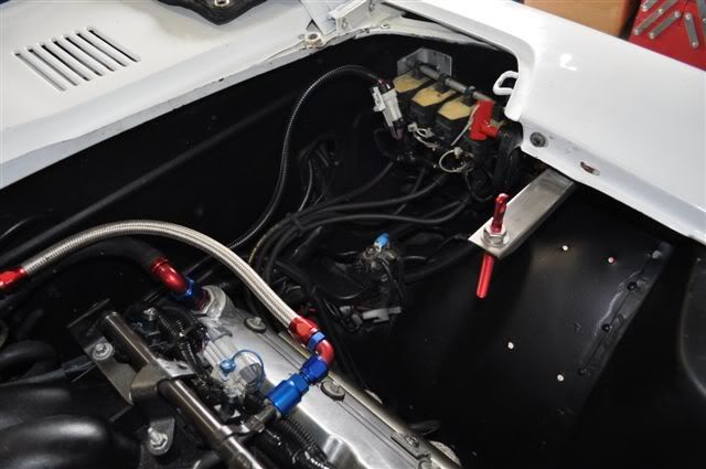

Relocated coils.
http://i16.photobucket.com/albums/b2...e250641616.jpg
http://i16.photobucket.com/albums/b2...e250641613.jpg
http://i16.photobucket.com/albums/b2...e250641611.jpg
http://i16.photobucket.com/albums/b2...e250641612.jpg
http://i16.photobucket.com/albums/b2...e250641606.jpg
http://i16.photobucket.com/albums/b2...e250641605.jpg

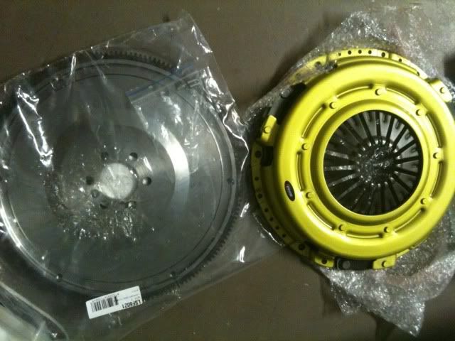

Because the car is so light, I don’t need a hard core replacement clutch as this will ruin drivability and give me a tougher pedal. The LS7 clutches sound perfect and I will be getting one as soon as I'm set up in my new place. Replacing this for me will involve removing the engine and gearbox together so that should be fun. I have been collecting parts to do a few things while the engine is out and separated from the gearbox. Apart from a new clutch, I’ll have a new slave cylinder/throw out bearing and new spigot bearing to go in. I think my spigot is dying and the extra drag on the input shaft is keeping it turning during gear changes. A new bearing here should see my changes improve. A new braided line from the master to the slave should improve pedal feel too.
My rear main has always had a leak so I’ve got a new crank seal to go on. Hopefully that’s all it is. I’ve got a new timing chain to go on as well as an under driven balancer. I also bought a used LS1 oil pump off ebay for $1 + $10 postage. I’ve used this spare to carry out a few mods commonly done to the LS1 oil pump. Porting the inlet and exits of the pump and shimming the relief valve. Easy to do, and the extra flow may save me in on track event. All this collecting parts has me thinking about a bigger cam now. Just a small cam……. I’m pretty sure I’m going all Bogan again now. I don’t need any extra power. This thing pulls like a steam train as is, but its not enough any more. Do I install a cam while I’ve got the engine out? I’ve got that spare set of cylinder heads too. I’m thinking of given them a tickle to smooth out the ports and valve guides and port match the flange surface. Then get them shaved a bit to ‘up’ the compression. I’ve got the better valve springs to go on yet, as well as the LS6 injectors, and the custom fuel rail. I’ll probably order some ARP head bolts and flywheel bolts etc to keep it all together. Man I’ve got so much to do. I cant wait to move down there and get into a house with a shed so the fun can begin. I also have to a bit more to strengthen the chassis too. Until then….

man that clutch looks fraged!. Im enjoying this thread in fact I might go back to the start and reread the install :goodjob:
Re: 1971 LS1 240Z aka 570Z
What clutch did u end up getting?
I got talked out of an LS7 clutch and went with a level 2 ceramic from Clutch Industries. I searched on here for others with these clutchs and there was a couple of mentions but not a lot.

looking at the engine bay have you considered tilting the radiator and running a OTR or isnt there enough room
I havent had a good look but that is always an option down the track. Isnt much room though.

New slave
http://i16.photobucket.com/albums/b2...e250642133.jpg
I extended the clutch fluid 'in' fitting so the braided hose didnt have to bend on such an angle to get to the master cyclinder.
http://i16.photobucket.com/albums/b2...e250642145.jpg
I just have to get the right fitting to go into the slave on the fluid 'out' line and I will hook up a remote bleed line. It looks like an M8 x 1.25 or a common bolt thread.
http://i16.photobucket.com/albums/b2...e250642146.jpg

Probably boring everyone with the photos but my new clutch and lightened flywheel arrived yesterday. Even came with a new bearing for the slave and pressure plate bolts, nice. All ready to go for my next days off.
http://i16.photobucket.com/albums/b2...X/9ccaf548.jpg
http://i16.photobucket.com/albums/b2...X/e25aa04a.jpg
