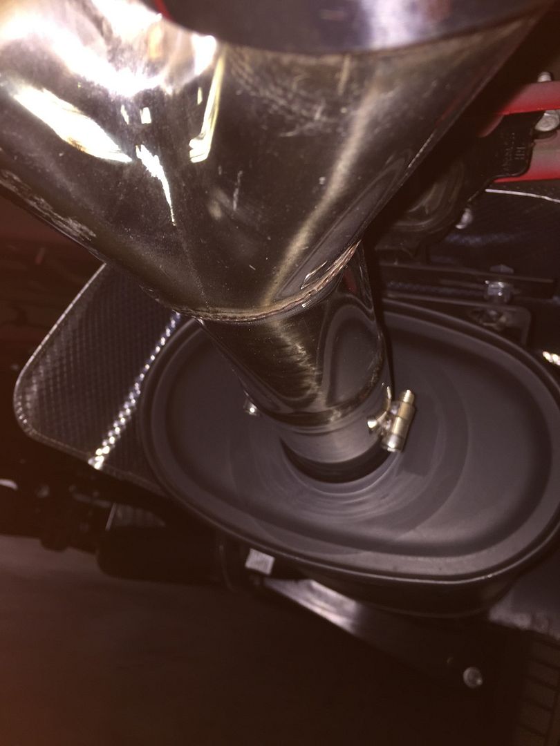

This is part of my disappointment.
I would have thought I would have proper dual muffler outlets
http://i299.photobucket.com/albums/m...pscwdg0yro.jpg
Re: First post VF 2 SSV Redline ute
Yes mate it is! But even the so called top of the range KPM do the exact same! Another reason I will most likely stick with OEM catback & a decent set of headers & high flow cats.
Micks
Strangely I have seen KPM systems with both Y pipe tips and full dual outlets. Just guessing here but maybe the SLC systems (like mine on the Senator) are Y pipe tips and the true Exhaust Technology KPM systems have full duals? :confused:
Gaz doubt it would cause any performance or sound difference with those systems.
