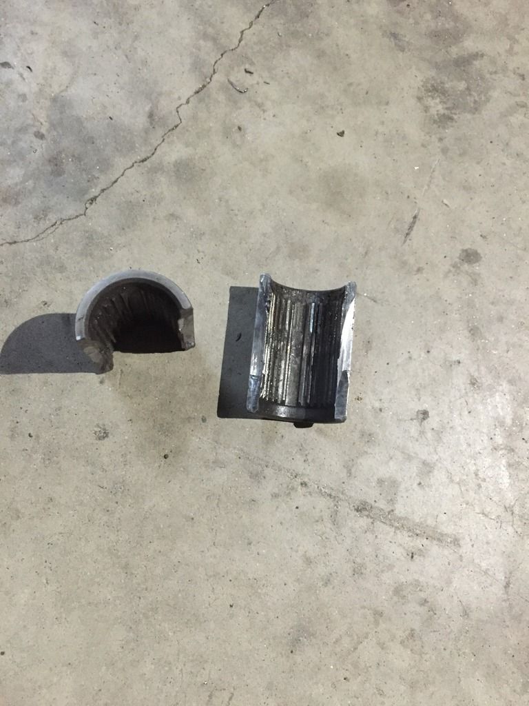

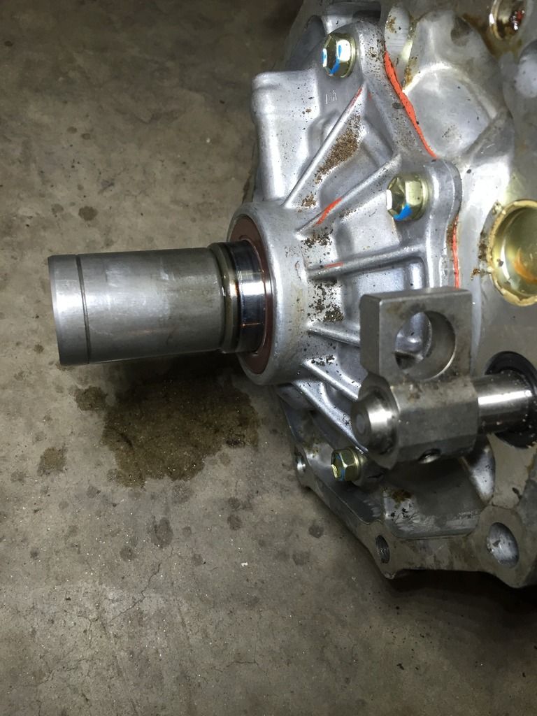

Separated the engine and box the other day so I can replace the output shaft with the new modified one to fit with the adaptor and transfer case.
Noticed the bell housing has a few cracks so will replace that while it is apart. Man those torx screws are a right pain in the ass to get out
