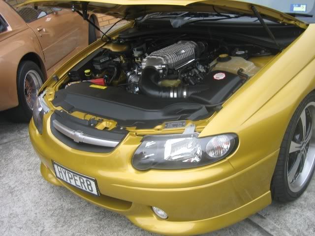

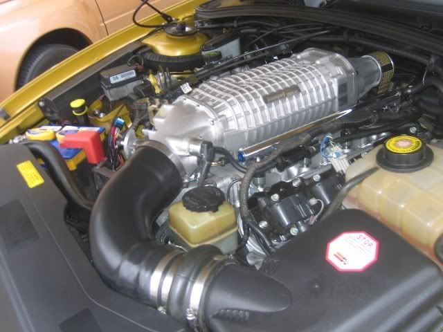

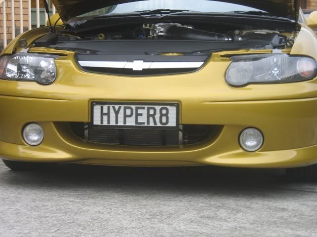

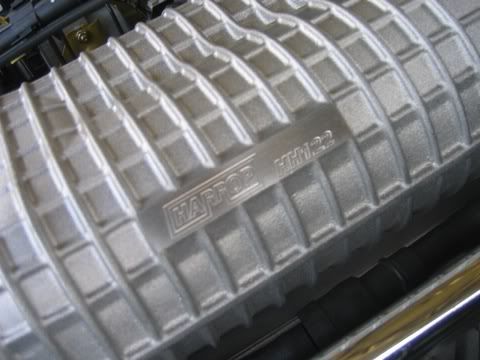

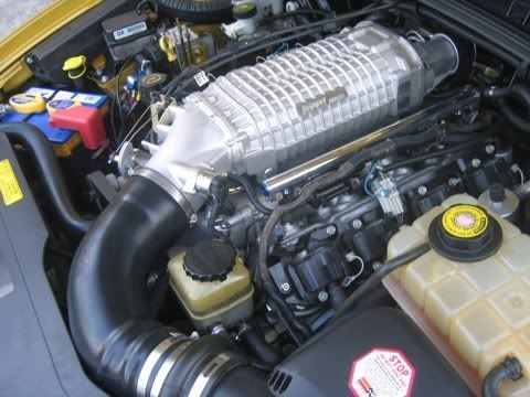

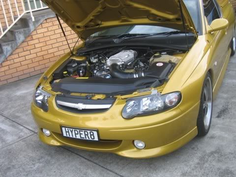

Just got my ute back home yesterday from G&D Performance in Vic,
Harrop HH122 Supercharger, Intercooler & 92mm TB.
G&D FI3 custom grind cam 232/242-117, Nice grunty idle now!
Crow cams Double valve springs, valve stem seals,
Double row timing chain, 50lb Rochester injectors, Fuel swirl pot,
Bosch 044 MS pump, Aeromotive Pressure reg and high pres lines.
Mafless 2bar Tune and thermostat mod.
End result was 345rwkw in 32 degree heat, not sure if the heat affects the dyno output or not but it was a hot day! The car is brilliant on the road.
The guys did an awsome job and i thank them very much cause i put them under the pump of 3 days, ended up being 4 but all is good thanks to Matt and the G&D team.
Will post more pics and vids 2morrow,
Cheers Trent.
http://i43.photobucket.com/albums/e3...r8HH122009.jpg
http://i43.photobucket.com/albums/e3...r8HH122008.jpg
http://i43.photobucket.com/albums/e3...per8HH1221.jpg

Looks like a nice setup mate.
Just a little curious about the cam choice? Did you have it done at the same time or was it existing?
I would have expected a cam that large to make 310-320rwkw on its own. Just wondering what the restriction is as I would have thought a figure of 370-380rwkw closer to the mark with the setup you have.
Restrictive exhaust????
I'm not having a dig at the product or the install at all, just curious. I'm sure G&D will have the answer :wave:

The cam was done last week same time as the Blower, the exhaust is 4 into 1 1&3/4" Pacmakers, 2.5" HF cats, Twin 2.5" mandrel Manta exhaust no res exits L/R, matt said the exhaust was fine.
When it was dynoed on the power runs it had been on the dyno for about 5 hours tuning in 32 degree heat, matt did say it could have a small effect on the final output, he also said they did a safe conservaitve tune as i live in tassie no one has the software or can tune these, so better safe than sorry i guess. He was also expecting between 350-360rwkw.
But it is an animal on the road, i'll probably have it dynoed again sometime this year at a dyno day.
Would of been nice to crack 350rwkw thats what i wanted but i'll just have to work on that, 345rwkw aint bad.
310-330rwkw is waht they have been roughly getting out of theses Harrop kits so the cam probably gives 20-30rwkw which seems to be the trend on most cars i've seen.
Cheers, Trent

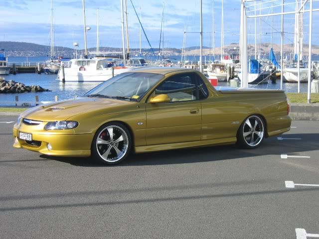

Full list of mods,
Vehicle: 2002 Holden SS Ute II
Engine: 5.7 Litre LS1
Engine Mods: Harrop HH122 Supercharger, Water to air Intercooler & 92mm Throttle body. G&D FI3 custom grind cam 232/242LS117, Crow Cams Double valve springs, valve stem seals, Rollmaster Double row timing chain, 50lb Rochester injectors, Fuel swirl pot, Bosch 044 MS pump, Aeromotive Pressure reg and high pres lines. Mafless 2bar Tune and thermostat modification.
Trans: 6 Speed Manual
Exhaust: 1 3/4" Pacemaker 4-1 Headers, 2.5" High flow cats, Twin 2.5" Mandrel Bent Manta exiting either side, no resonators
ECU: Tuned on VCM Suite Maffless 2bar
Power: 345rwkw on dyno dynamics dyno
Suspension: Kings Superlow springs front, Kings SSSL rear springs, Koni internal adjustable shocks and struts, rear camber/toe kit
Brakes: 330mm PBR vented/slotted rotors (F), 315mm PBR vented/slotted rotors (R), PBR Larger Twin piston calipers in red (F), PBR Larger single piston calipers red (R), Steel braided lines all round
Wheels: 19x8 TAK Legend
Tyres: 245/35R19 Maxxis MAZ1
Stereo: Stock
Interior: Factory Yellow leater trim, Momo Knob
Exterior: VZ Monaro bonnet, Custom Plastic welded front to suit VY Chev grille, HBD Hard tonneau, VY II Tail lights, Rear chev badge

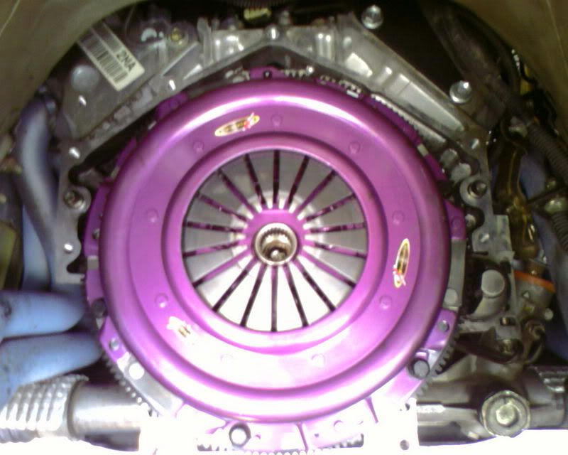

What clutch are you running in this?
Me, my brother, and old man put a new one in 2 months ago ready for it @ work, An Extreme, Heavy Duty, Cusion button with lightened chrome moly flywheel and VY slave.
I didn't mention in the specs it also has a flat bed K&N filter and HSV CAI which i'm replacing in a couple months with G&D's close airbox with CAI and pod.

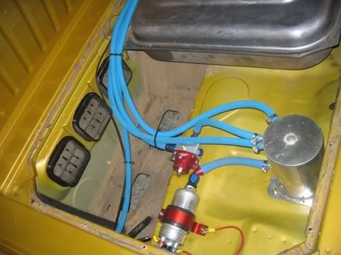

Heres some more pics behind the scenes the new fuel system and Extreme Clutch.
http://i43.photobucket.com/albums/e3...ss/fuelsys.jpg
http://i43.photobucket.com/albums/e3...3ss/Clutch.jpg
