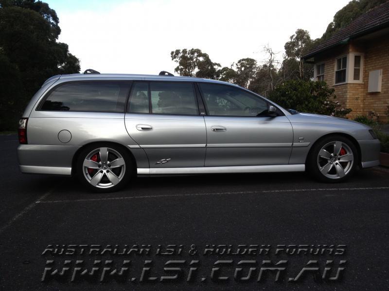

Model: 2004 VYII SS Wagon
Colour: Quick Silver
Bodykit: SS

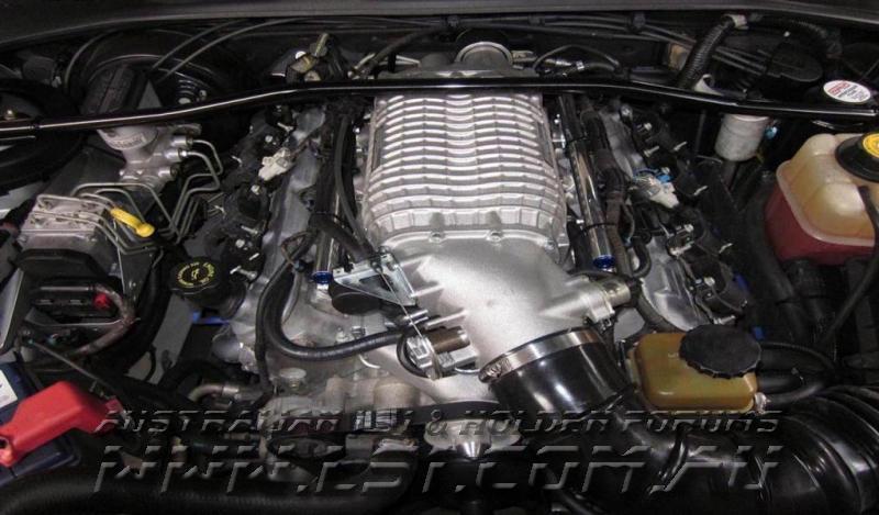

Engine Type: 5.7ltr
- Complete rebuild (Machined/Balanced/Blueprinted)
- 9.3:1 static comp
- Fuel: BP 98
- Power: 324rwkw
Engine Mods:
- Harrop HTV1900 10lb inter cooled Blower kit
- Pro Pac LS Beehive Valve Springs
- Clive 'Custom' Cam + Push Rods
- Morel Tie bar Lifters
- CP Bullet Pistons (Dished)
- Scat I Beam Rods
- Clevit Bearings
- Moroso HP Oil pump
- ARP main/head stud kit
- LS2 timing chain/kit
- 10% Overdrive pulley
- Pin Balancer
- Elite Catch can
- Walbro Performance In tank Fuel Pump
- 60lb injectors
Exhaust:
- Pacemaker Stainless Tri-Y headers
- Pacemaker Stainless Hi flow Cats
- Pacemaker Stainless 2.5" Dual system
Tuned @ APS
Gearbox: Built 4l60e
- 2200 Stall (lock up)
- 3/4 Drum Capsule, Mod Valve Body & Separator Plate, Beast Drive Shell
- Mod 3/4 Accumulator & Boost Valve, Converter
- Raybestos ZPak 3/4 clutch pack
- Shift kit
- New 5 Pinion planetary gear sets
- B&M Deep Pan
- A4 Tranny cooler

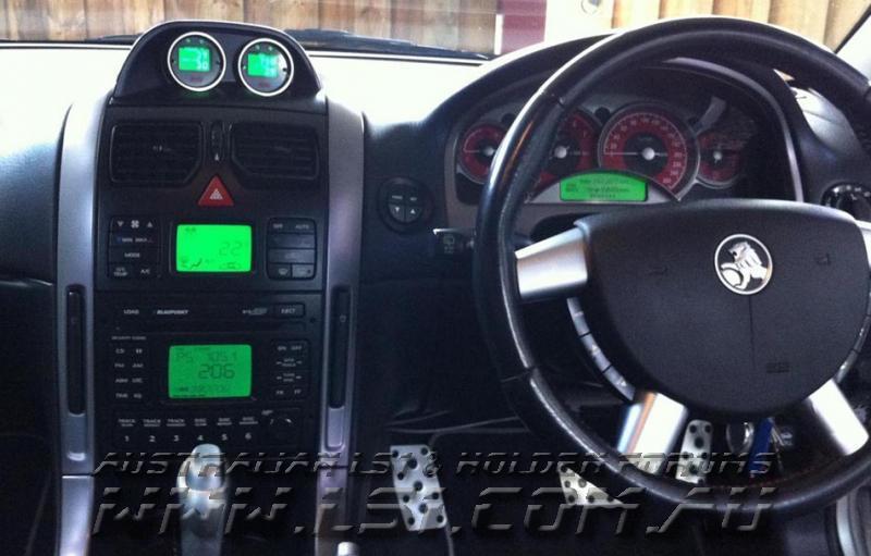

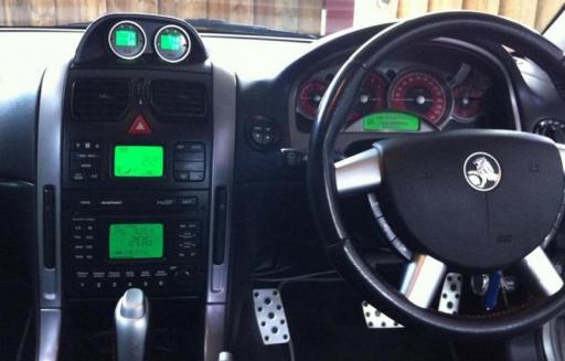

Interior:
- Standard (Black) SS Leather
- HSV Pod with dual Aeroforce Gauges (including analogue AFR and Boost)
- Viper Alarm system (+ remote start/GPS tracking)
- BlackVue DVR
- Double Din Head Unit + Reversing camera
- Alpine 4 channel amp + speaker upgrade (+ Dynomat)
