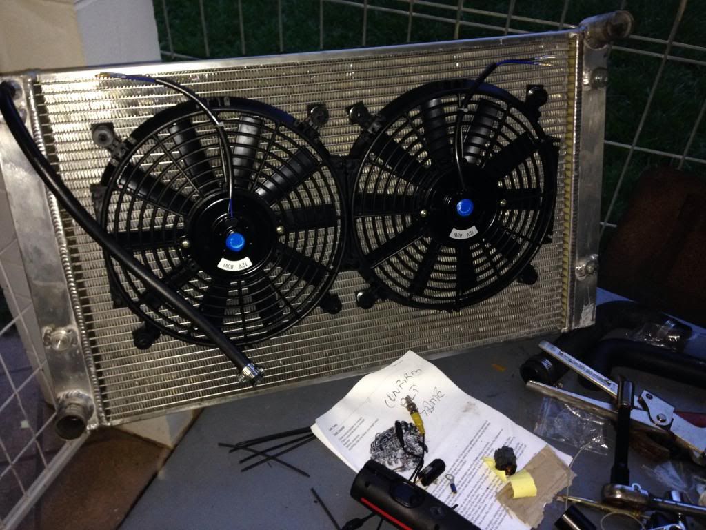

    I tried it and it did not work too well. I ran two 12 inch fans without the ducting and found that temps were all over the place. On the street in the silly hot darwin weather I had to turn the AC off after a 20 min drive just to keep it cool. Once the AC was off it was fine and came back to normal really quick even in stop start traffic.
    When I spoke to the mechanic about the issue he said their is a nsaty swirling affect that happens when you dont have the ducts and can make the car run hotter.
    I put the stock fans and duct back on and all good regardless of AC etc. Worked on the cicruit too. Stupid hot last weekend and after a few laps at full belt stayed pretty good. Last time out with the fan without the ducting it temps came up after a lap and did not go back down. Under high speed the fans do nothing but the duct still does it job.
    Photo of the set up I used. I still use the big aftermarket radiator too. Also mastered the bleeding of these big radiators too with some advise from Mr Mainlube. Worked a treat after getting it right.

    I can see why the above setup is not up to scratch! Been working with fans for thirty years now & to have two fans there like shown will not attract all those fins per inch as there suppose to! You would have been better off with a single & a nice snout instead of two!! Very hard to beat the OEM or pretty them up as they literally spent millions on this!

    Quote Originally Posted by Micks View Post
    Thought was I rarely use the car at town driving so more flow the better but I did not count on the ducting having a effect even when fans are not on
    Live and learn
